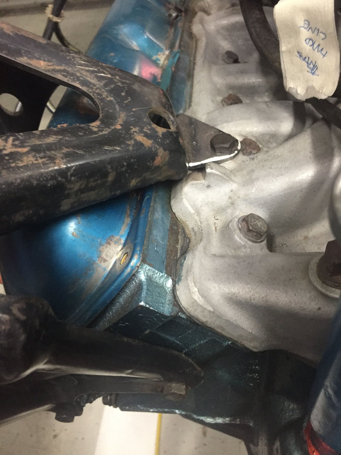

First, all Olds A6 brackets are NOT created equal. There are differences from year-to-year and even from model-to-model (in 1967, for example, the B/C-body cars used different brackets than did the A-body cars).
Second, your problem is obvious from this photo.
The notch in the intake is not large enough to clear the tab on the bracket. Grind the tab to fit. This will allow it to sit all the way down on the head bolt stud. Problem solved.

Thank you for the feedback, I appreciate it. My Performer intake is easily 20 years old so if there were a manufacturing defect this one would have it too. I'm unsure about grinding the bracket or wallowing out the hole because:
I don't think this is the correct part. It seems to be "too small". I separated the back half of the bracket from the front half and the "adjuster ring" (in an attempt to fit the manifold bolt and the head stud) and made a new album:
https://flic.kr/s/aHsm6wQrw8
The first three photos show the intake bolt installed, and how the lower hole doesn't come anywhere close to fitting over the head stud when the intake manifold bolt is installed.
Photos 4 thru 8 show the lower hole fit over the head stud, and how that results in the mismatch on the intake manifold bolt. ALSO shown is how the lower part of the bracket is NEVER going to shoulder up to the head stud nut, as it hits the lower rail of the valve cover first.

Once again, your problem is the aftermarket intake manifold. Note the relationship between the boss where that bracket mounts and the top surface of the no. 2 runner on this W-30 intake. Note how it sticks up as opposed to the recessed location on yours.

This doesn't look "recessed" to my eyes. Even if the boss was higher the bracket I have isn't "a big enough circle" (viewed longitudinally) to mate with both the hole and the stud.
AND the bracket still hits the valve cover before it shoulders out. If there's supposed to be a spacer there that MAY make a difference but the word around here on that was "no".

The SBO and BBO heads are externally dimensionally identical. The head bolt locations are dimensionally identical. The valve covers are identical (except for the later 307 covers that are slightly different). What could possibly be different in how the A/C bracket fits? Do you have extra thick valve cover gaskets to clear roller rockers?
Again, you cannot bolt the bracket to the intake first and then try to put it over the stud. That is physically impossible. You have to put it on the stud first then bolt it to the head. If the mounting boss on the intake is too low, the bracket will hit the valve cover. Without having the E-brock next to an OEM intake for comparison, it is impossible to know if that is the problem.

I called in the Marines and got this fixed up last Sunday afternoon.
The modification shown is required to use a c. 1977 factory stamped steel A6 air conditioner compressor bracket on a 455 equipped with OEM heads and the Edelbrock Performer aluminum intake (the hole in the intake manifold for the A/C bracket is "not in the right place").

Pictured below. These are the parts I used, which look like the same parts you are looking at. I still had to a bit of hole hogging on the bracket to make it fit without binding.
https://www.summitracing.com/parts/VTA-141008
https://www.summitracing.com/parts/v...-vuq/overview/
Originally Posted by Macadoo
Oops, I deleted the post since I think I found the parts. But why not verify since I have you on the line:
https://www.summitracing.com/parts/vta-04808-vuq
https://www.summitracing.com/parts/vta-141008
Originally Posted by mrw8i
If the plan is to use a Vintage Air Sanden AC bracket, be careful if you purchase off of eBay. If you are good with working with metal and have the tools - then purchase a copy cat part off of eBay, and expect to do a a few hours of work to get it to fit. If you are not good with working metal then make sure you purchase a Vintage Air bracket.
Last week I purchased the bracket off of eBay for $109. It was a copy of the Vintage Air bracket. There are the issues I found with the kit.
1 - The kit should have 5 spacer washers, this kit had 4. If you have to space the compressor away from the valve cover like I do, you need 5 spacer washers.
2 - I was unable to get all 3 bolts into the head because the holes were off on the bracket that bolts to the head. I could hole hogged one of them to get that to fit.
3 - There is a semi-circular bracket that bolts in 3 places to the front of the compressor, one of those holes was not drilled out large enough. I could have drilled that out.
4 - There is a threaded hole in the main bracket that is used for adjusting the tightness of the belt, it was not threaded. I could have purchased a hole threader and fixed that.
5 - There is a stabilizing arm between the main bracket and the water pump, the holes were more than 1/8" off. Not sure how to fix that, maybe more hole hogging but that bracket is not real wide and did not want to weaken it.
6 - The real instructions are 3 pages long plus a 4th page for parts list. This kit was one page, and it looks like a poor copy of the 2nd page of instructions from the Vintage Air instructions with a lot of stuff whited out and the companies name stamped on it.
At that point I figured if I did all that work to the parts, and I got it all together, and based on the poor copy of the real part; are other things off and will the pulleys line up? Since I want to return it, I put all back in the box.
I have tried to return the kit since Tuesday, I noted the above issues, I got a question back "What year is your engine" I answered that 1973, and added it's a 455 - which is the other obvious question they should have asked. I have not heard back for 3 days.
Yesterday I ordered the Vintage Air brackets from Summit for $129. Today I received it. It's tight fit on the head, but all 3 bolts go in without forcing. The stabilizing arm between the water pump and the bracket is tight - but it fits; I will probably drill this out a tiny bit so it is not so tight. I need all 5 spacer washers. This kit was missing a 2-3/4" bolt which it should have come with - but that I can deal with.
What I don't like about both kits. They use nylon lock bolts. Nylon doesn't hold up well under heat for a real long time. Okay on suspension parts, not okay where things can get really hot. Maybe on AC brackets they are okay, but not what I will probably end up with.
This is the Vintage Air Bracket:
5 spacer washers to move it away from valve cover
Front showing stabilizer arm.
