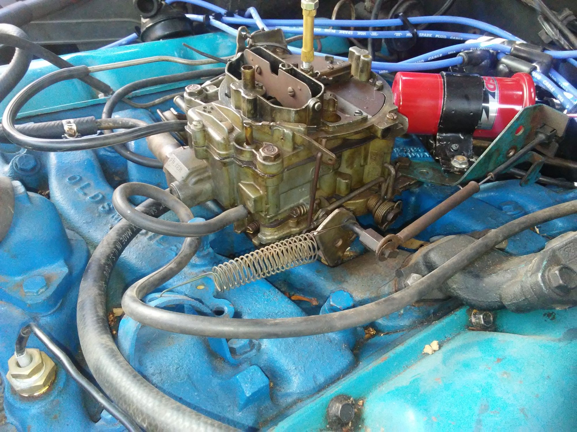

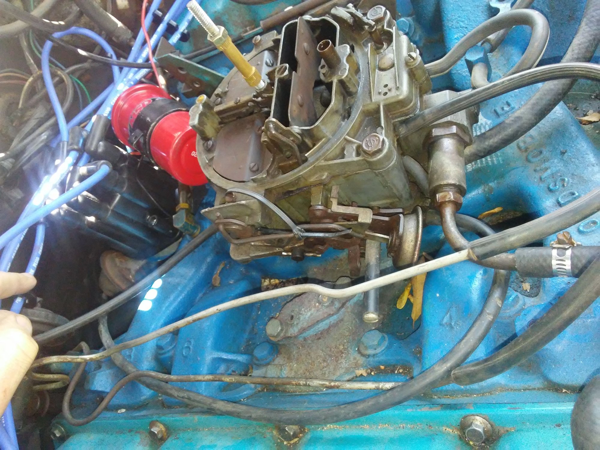

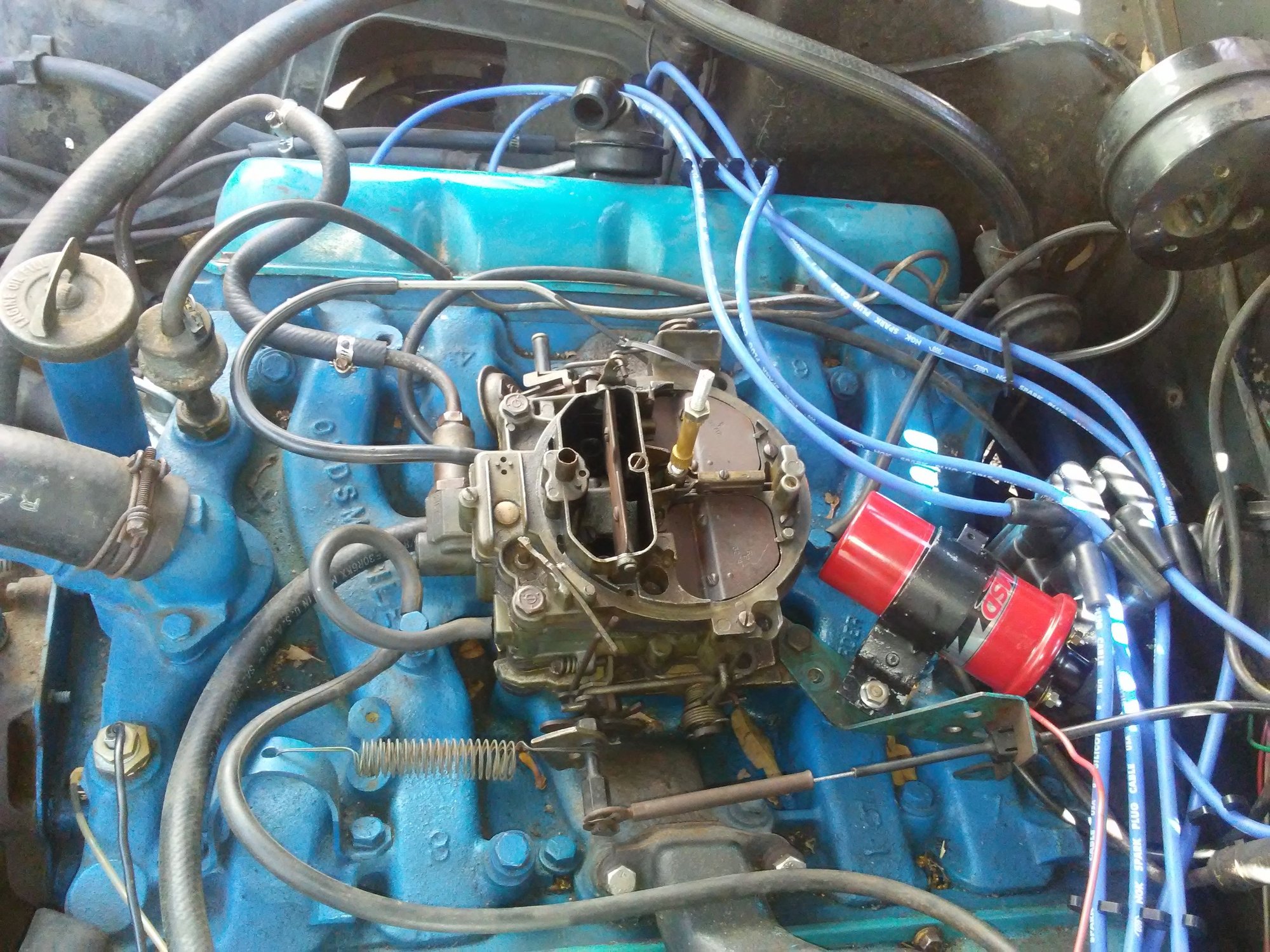

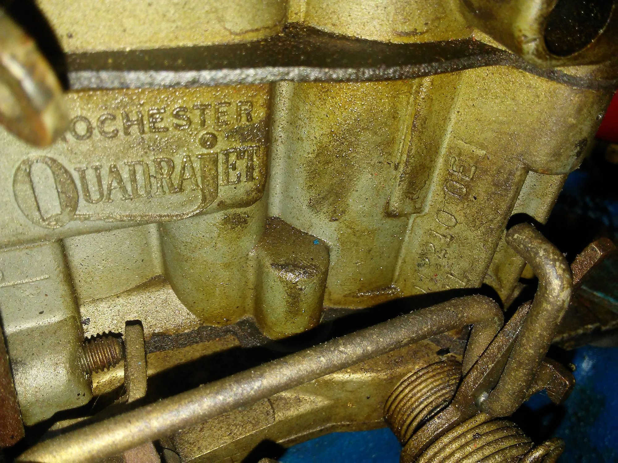

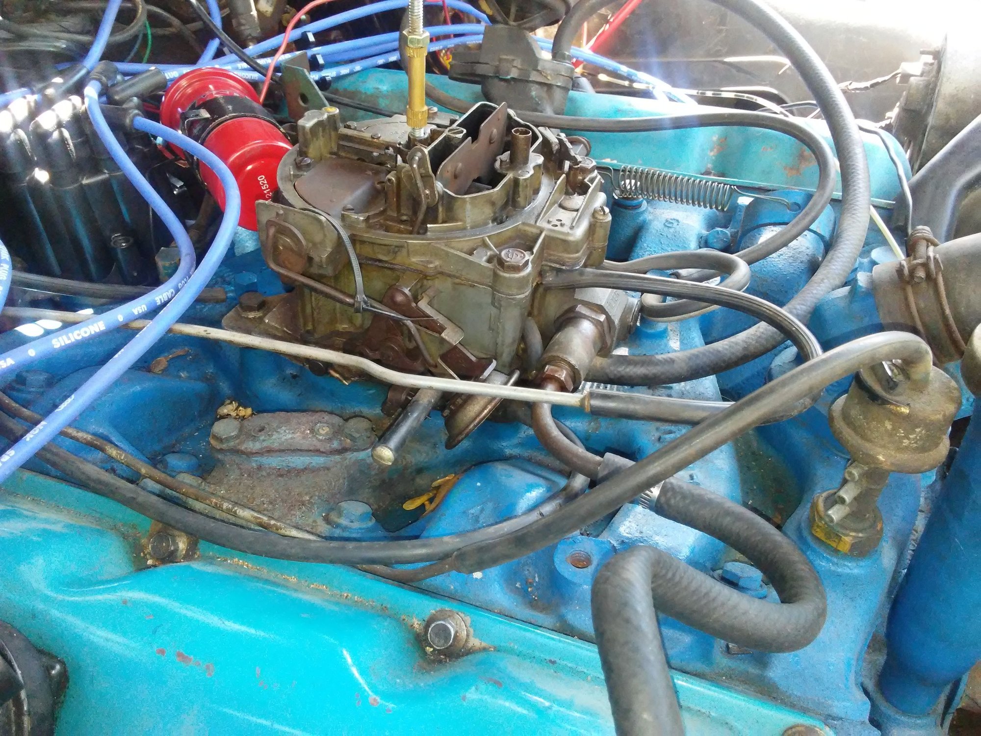

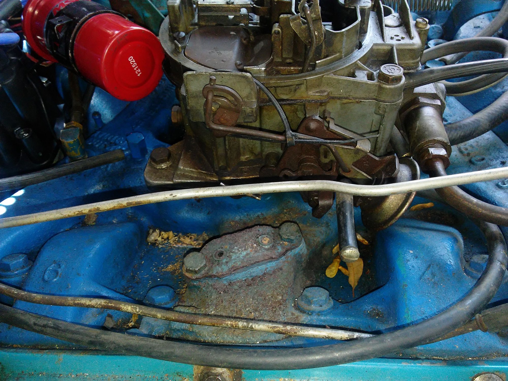

Added some pictures of what I'm working with.

You might want to start by throwing away all those randomly-connected vacuum lines and replumbing the vacuum correctly. I can't tell if that's a 7042210 or 7043210 carb, but either way that's off of a Chevy truck 350, either 1972 or 73 depending on what that number really is.
The modulator line from the trans connects directly to manifold vacuum. Use one of the ports tapped into an intake runner.
The TVS with the unconnected ports just needs to go away. You obviously aren't running the Transmission Controlled Spark system.
The distributor vacuum advance line connects to either direct manifold vacuum or ported vacuum, depending on which one makes it run better. If you want ported vacuum, use a vacuum gauge to figure out which of those ports on the front of the carb is ported. I can't tell which port you have it connected to right now.
Depending on which heater control valve you have, the vacuum line from that valve to the intake manifold is either holding it open or holding it closed. Since you don't have A/C any more, remove that valve and replace it with a nipple with an orifice. Plug that vacuum port in the intake runner.
The hose from the front of the carb to the vacuum tee on the intake is doing nothing. If that carb port is a ported vacuum connection, the hose is screwing things up.
The hose from that vacuum tee that goes out of the photo is connected to what?
Plug every port that isn't being used. Your current vacuum lines are a mess, and that's possibly part of your problem.
