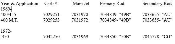

Have a original 400 big block engine in my 69 442. However, the carb is from a 72 442 (7042250). Looking to buy an original 69 442 qjet carb (7029251). What difference performance wise can I expect in using the 72 carb instead of the correct 69 carb?

Here's the metering jet/rod info I have for the 69 and 72 carbs. The 72 carb is a bit leaner but you can always change the jets and rods to tune it for your application.
