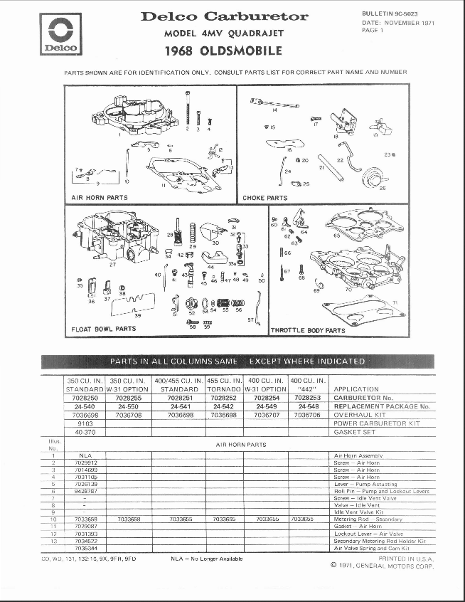

Hello, new to the forum. Great site! I am having difficulty finding info on the correct numbers Q-jet for a 68 BO7 455 390hp. I see the 7028251 RJ listed for all 455 and 390hp H/O for 68 but nothing that specific, perhaps that is correct for my application or is it going to be such an oddball it would be difficult to find? Anyone seen an original as installed from the factory? Also looking for info on the correct numbers distributor, I believe it is a unitized unit. Any ideas would be greatly appreciated. Thanks, Rick

Welcome. '8251 is the correct carb. The main difference in the W33 motor was the use of the 285/287 deg cam.

About carbs in general. Does a carb # indicate exactly how that carb was always jetted/calibrated or were #'s used on a few different applications and jetted according to the specifics of the application?
E.g., 7028251 used on a 455/365hp and a 455/390hp but jetted differently for each HP?

Precisely, the 7028251 was also used on the std 442 400 hence my questioning on that carb as being correct. The engineers must have used a 'paper dyno' to figure out which carbs would potentially work best for each given application. That would be a lot of real dyno time.

All 8251's would be calibrated the same, there was a standard Rochester spec sheet for them (I don't have it, I've seen it for the 8255). The 8250 was the 350 carb - shared most of the same parts as the 8251 but had different calibration.

The only differences between '8250 and '8251 were the secondary metering rods and the power piston spring.

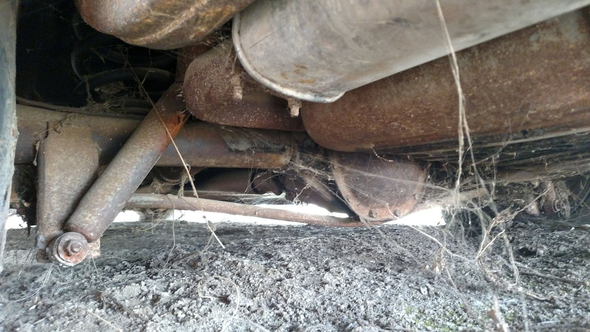

Great carb info! Unfortunately, the original carb, UHV distributor and air cleaner were stolen off the
original BO7 car. I am going to look at the car again and confirm original drivetrain sure looks to be, it is all there. Certified 120 speedo, rear sway bar, dual resonators out back, holes where dual spots used to sit on the pillars.

Actually, this is the money shot. The uber-rare rear sway bar and factory dual exhaust. Nice!

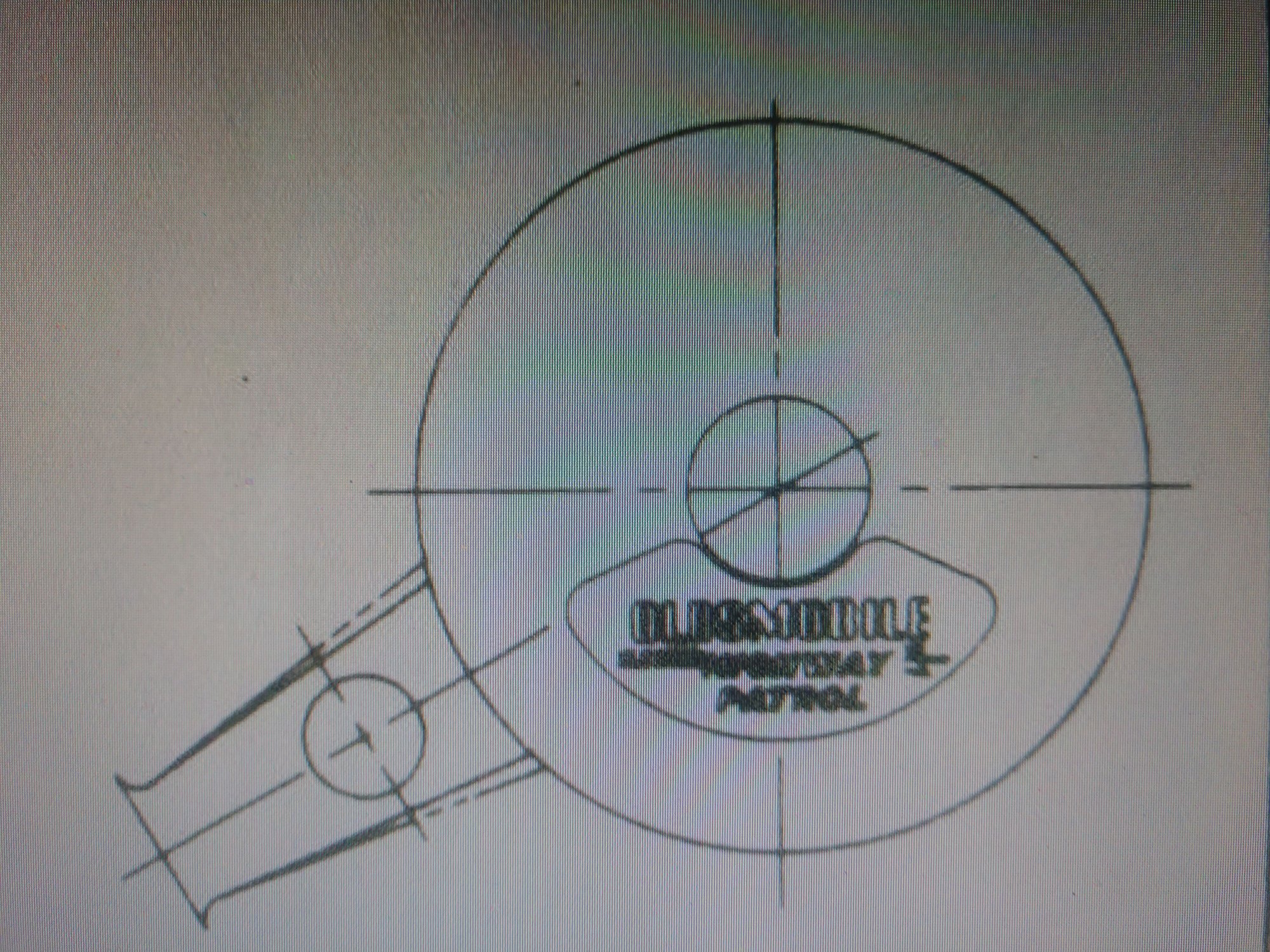

Looking for a 68 Delmont/Delta/98 455 4 barrel air cleaner
I don't believe the 68 BO7 had anything different regarding the air cleaner, so any for that year should work ? The snorkel on a 69 looks slightly different. Anyone ?
Old Apr 26, 2020 | 10:04 PM
Sugar Bear's Avatar
Posts: 4,098
I think the air cleaners were the same; however, I've not seen a correct reproduction decal. The 68 decal said Highway Patrol and in small print also said premium fuel only as did the gas tank cap.

Thanks for the info. I was wondering about sticker as well. The 69 sticker then appears to be reproduced. The Thermo pod on the 68 snorkel is placed closer to the air cleaner where the 69 is closer to the end of the snorkel.. from pics that I have seen.

This may be the 68 350/400 BO7 sticker sugar bear is referring to. So the 68 455 B07 used the standard Rocket 455 pie tin or did it use this sticker as well? I can't find an original engine pic of a 68 455 BO7.
