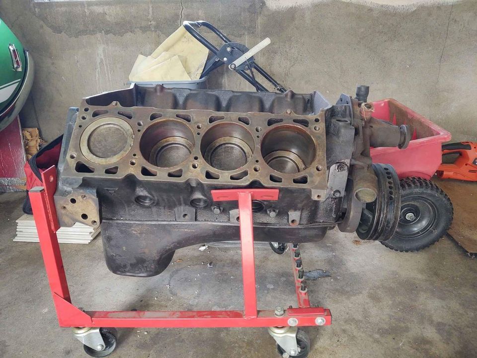

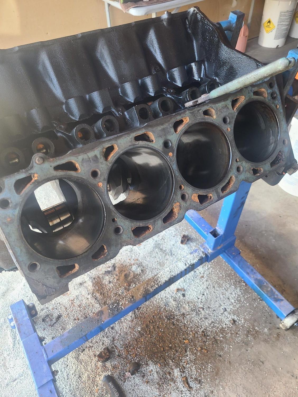

these are the pictures, it's listed locally but i have not went and looked at the cylinders up close.

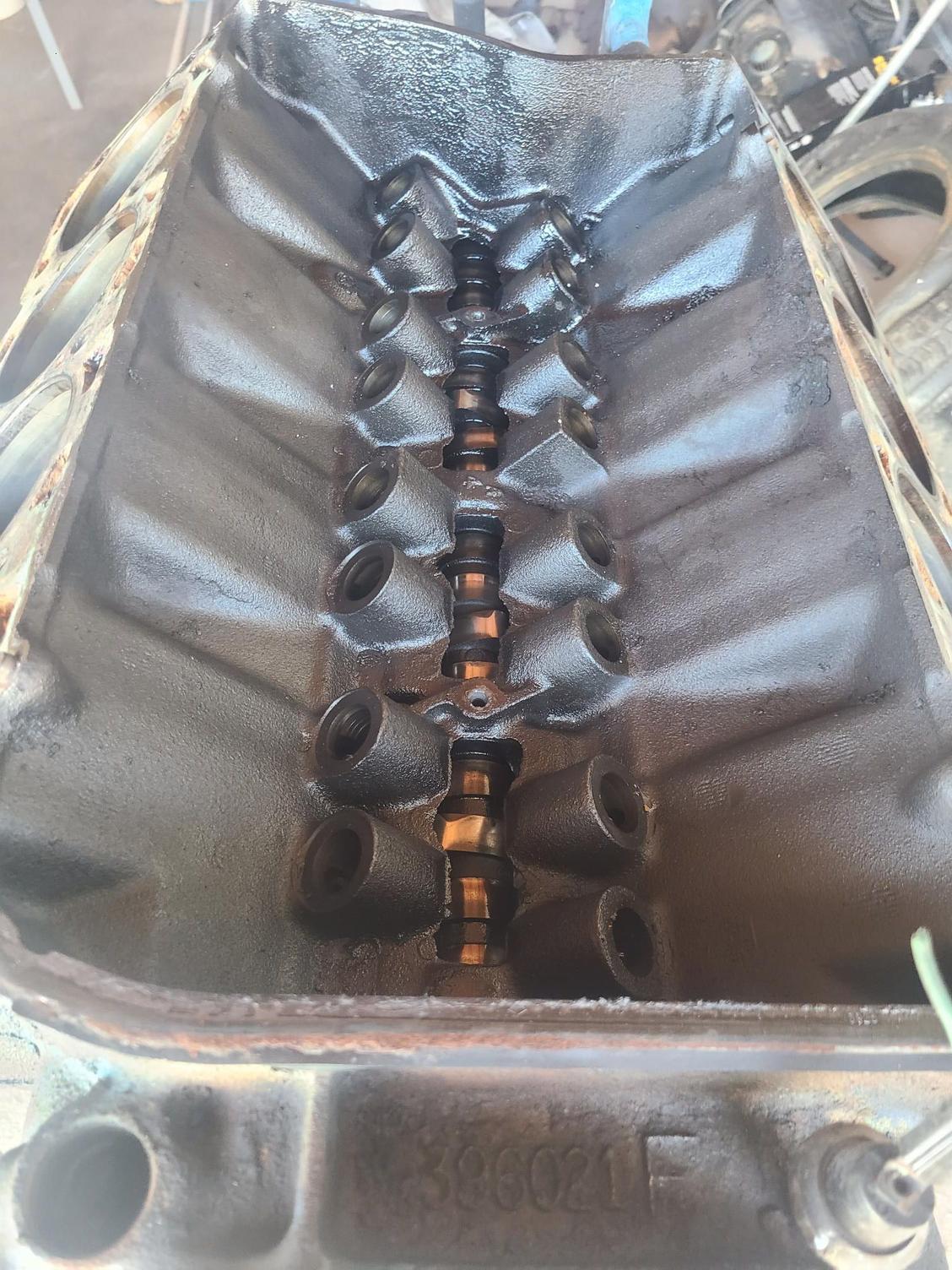

I think $500 is too much for just a short block but in its favor, it does look fairly clean and that could be a huge plus later.

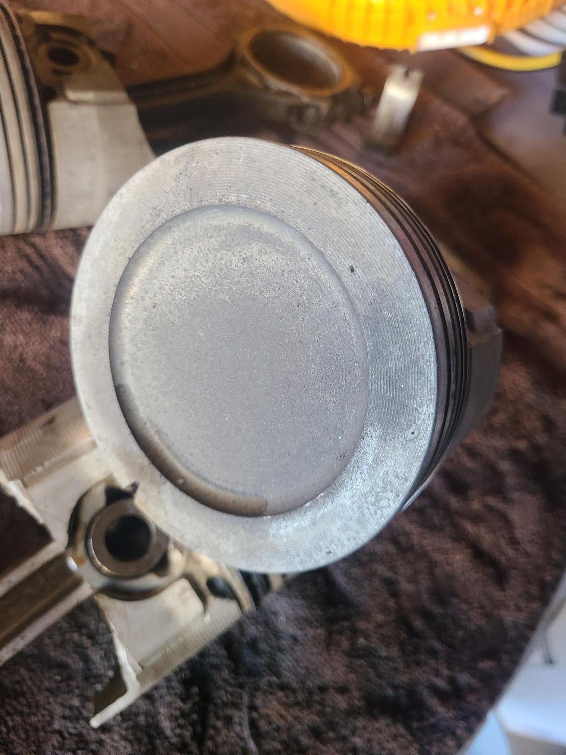

Looks like double round notch low compresion pistons. Cannot really see how good the cyliner walls look. Overall it is not encouraging. The next question is: What are your plans for the motor?
Will this be something to go on the street as a cruiser (intake, Mild cam, and a few other up grades)? Will it be an all out race motor? will it be inbetween? Low compression pistons can be good for a driver especailly with the cost of gas so high.

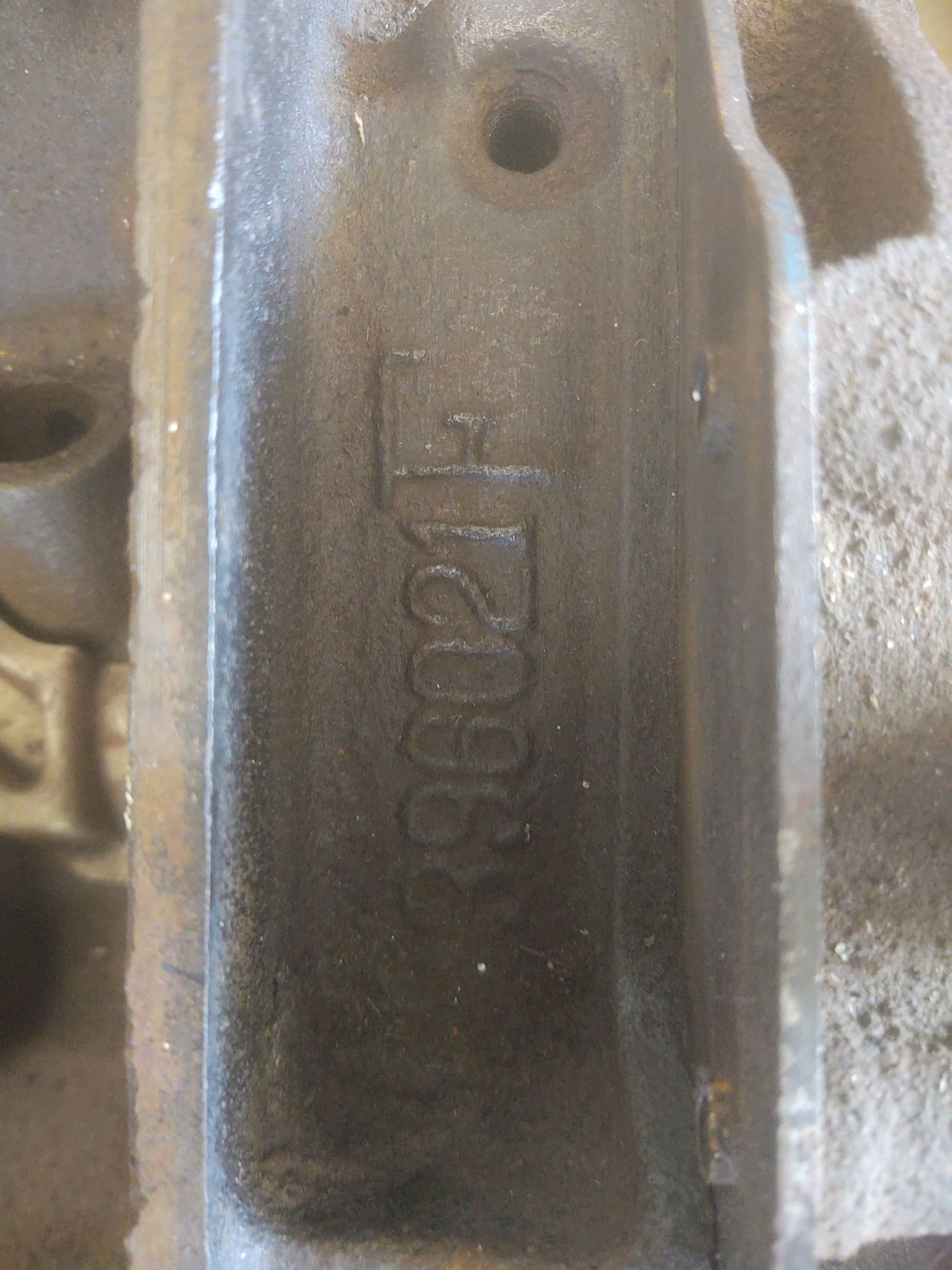

That 455 is a serif F and could be as late as 1974. I have a serif F that was originally in a 73.
