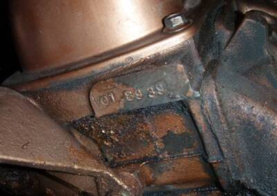

Hi would you please tell me where the engine code is? Is right above the water pump? It is several numbers and then ends with a letter?
There are also 6 numbers on the each side of the block - what do they mean?

The number above the water pump is the block casting number and tells you the displacement and year range of the engine.
The six digit numbers above the center exhaust ports are not on the block, they are on the heads and those are the head casting numbers.
In 1967, the engine unit number was stamped on the end of the RH cylinder head, though if the heads have ever been off the engine, they may have been installed on opposite sides (50-50 chance) so the unit number may be on the back of the LH head.

Hi Joe, thank you so much, here is what I found.
On the passenger side of the engine, it reads:
383821 (this is consistent with your pic)
On the drivers side of the engine, it reads:
394548 ( I don't know if this means anything
By the water pump, it reads:
389244D
The number on the passenger side front head reads:
M189229
Do I have a 400 or a 425 Engine?
Thank you!

I see, looks like I have one 383821 head that matches your head number.

389244D is a 1966-67 425 block
383821 is a 1965 "A" head casting and not original to this motor.
384548 is a 1967-69 "C" head casting and likely is original to the motor
M189229 is on the 1965 head and means that THAT HEAD came off of a 1965 425 2bbl motor. Unfortunately it won't tell you anything about the rest of the motor since that head isn't original.
Old Feb 3, 2017 | 02:17 PM
Posts: 50,770
That photo was only intended to be an example of what the cylinder head casting number looks like.
