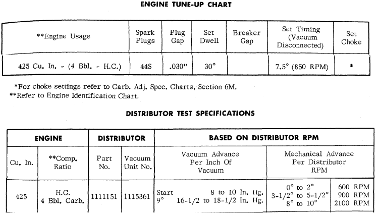

Just to be clear on the details, here are the specs for my distrubutor:
It took me some time, and lots of help on here to fully understand this table. The key being the bottom section (distributor test specs) is showing distributor RPM and advance degree numbers. Everything gets multiplied by 2X (except the vacuum "Hg) when you're using crankshaft degrees.
Breaks down like this:
At 1200 crank RPM (equiv to 600 distributor RPM), I should see 0-4 degrees of centrifugal advance. 1800 crank RPM (900 distributor), 6 to 11 degrees. Finally, at 4200 crank RPM (2100 distributor) I should see 16 to 20 degrees centrifugal advance. These numbers do not include the initial timing so you have to add the initial into the totals. So at the higher RPM I should be seeing 24 to 28 degrees total on the light. In my case, however, it's a max of 19.
Vacuum advance should start advancing at 8 to 10 "Hg and add 18 degrees at 16.5 to 18.5 "Hg.
I know you guys know all about this, just wanted to show the specs I'm working with and what I expect to see vs. what I'm actually seeing.

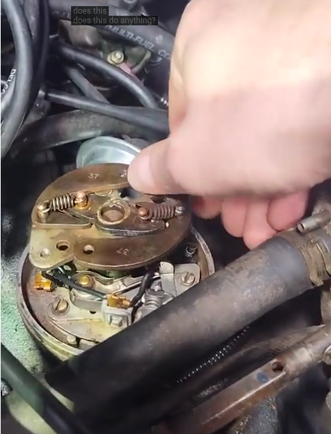

Old Yesterday | 12:43 PM
ourkid2000's Avatar
Posts: 1,243
From: Nova Scotia, Canada
Made a quick short of the distributor. I have no reference for what is acceptable. Maybe someone else will see a problem......
Old Yesterday | 12:50 PM
Posts: 15,333
Your weights are installed backwards from how my HEI is. I would have to dig out my points distributor to see if it’s the same or different.
I am not really sure if it makes any difference.
Old Yesterday | 01:08 PM
Posts: 15,333
I found this in a search:
https://classicoldsmobile.com/forums...prings-170146/
I believe the wide end of the counterweight trails the rotation. I am trying to explain that the thick part comes after the pivot pin because the rotation is CCW. DON'T do it like a Chebby, its opposite.
I couldn't find a good picture.

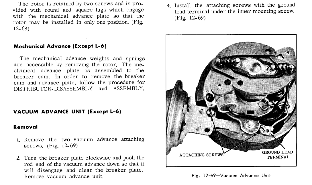

Old Yesterday | 02:37 PM
ourkid2000's Avatar
Posts: 1,243
Here is a snapshot from the '66 CSM electrical section:
Screenshot from my video, they look the same to me:
