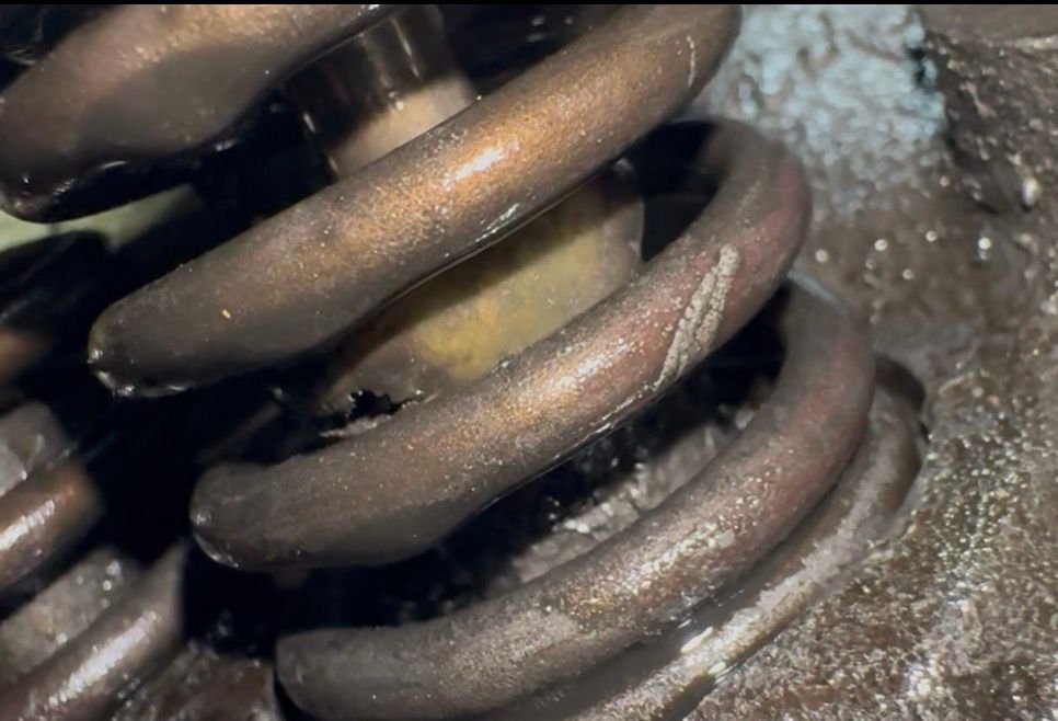

Noticed the engine ticking a few days back, and after tracking the sound down with my engine stethoscope, I popped off the driver side manifold.
Well, uh oh...found that the number three piston exhaust valve seal was burned, AND there were metal shavings around the spring. I just installed new valve seals last summer.
I was stumped on figuring out the source of the shavings thinking that the valve guides were bronze. My research yesterday taught me that these engines used steel guides.
Last night, Hudson and I removed the rocker arm shaft and confirmed that there is A LOT of play with the offending valve.

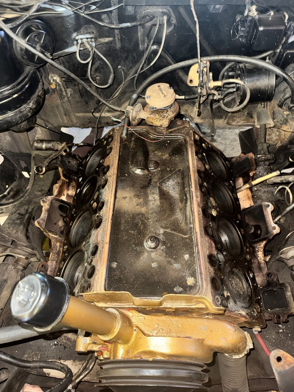

Well, it was a nice weekend, so I was able to get through a bunch of tasks. One of which was getting the heads pulled off the engine! It was no easy task...thanks goodness for my engine hoist for lifting those heavy buggers out!
Dropped the heads off to the machine shop yesterday. He is going to give them a once-over this week and figure out what they will need and what parts I need to source - Just in time for Homecoming! He saw the metal head gaskets and said that they were the original ones. Interesting that this is the fist time this engine has been open. Testament to build quality.
Before I took the engine apart, I did both dry and wet compression tests. Only one cylinder was low. The low cylinder is the number 3 - which is the one that had the bad valve guide. So, I am hoping that the low compression number comes from the valve issues on that one.

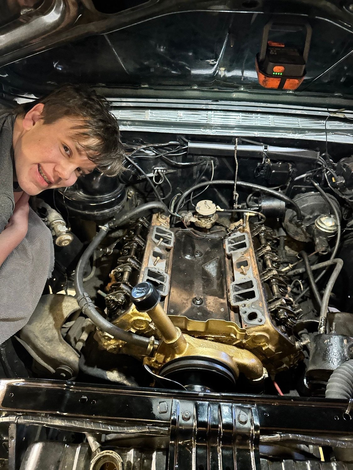

Intake manifold removed! Hudson is ready to tear into the head removal!

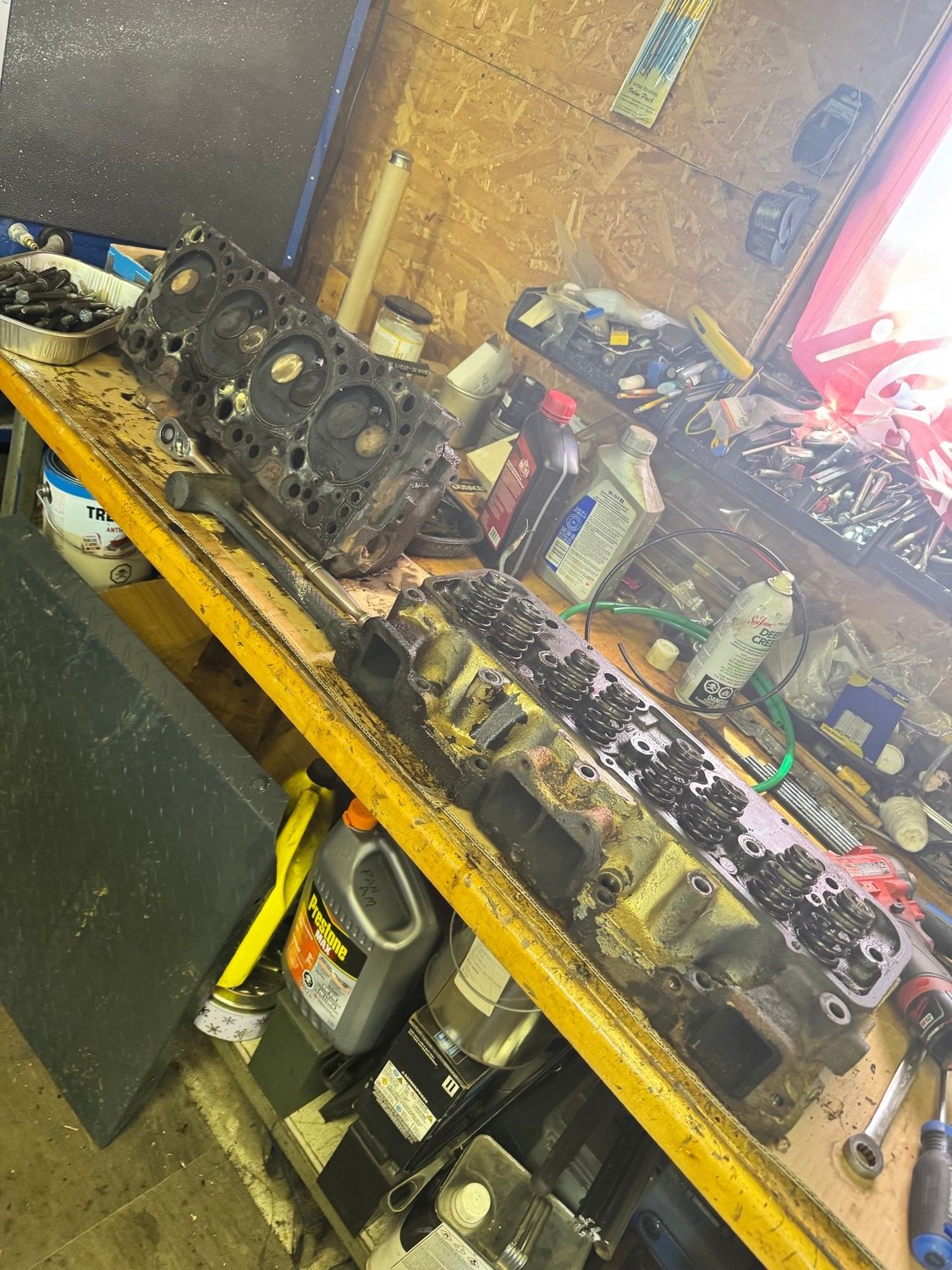

Phew!  Driver's side off and on the bench

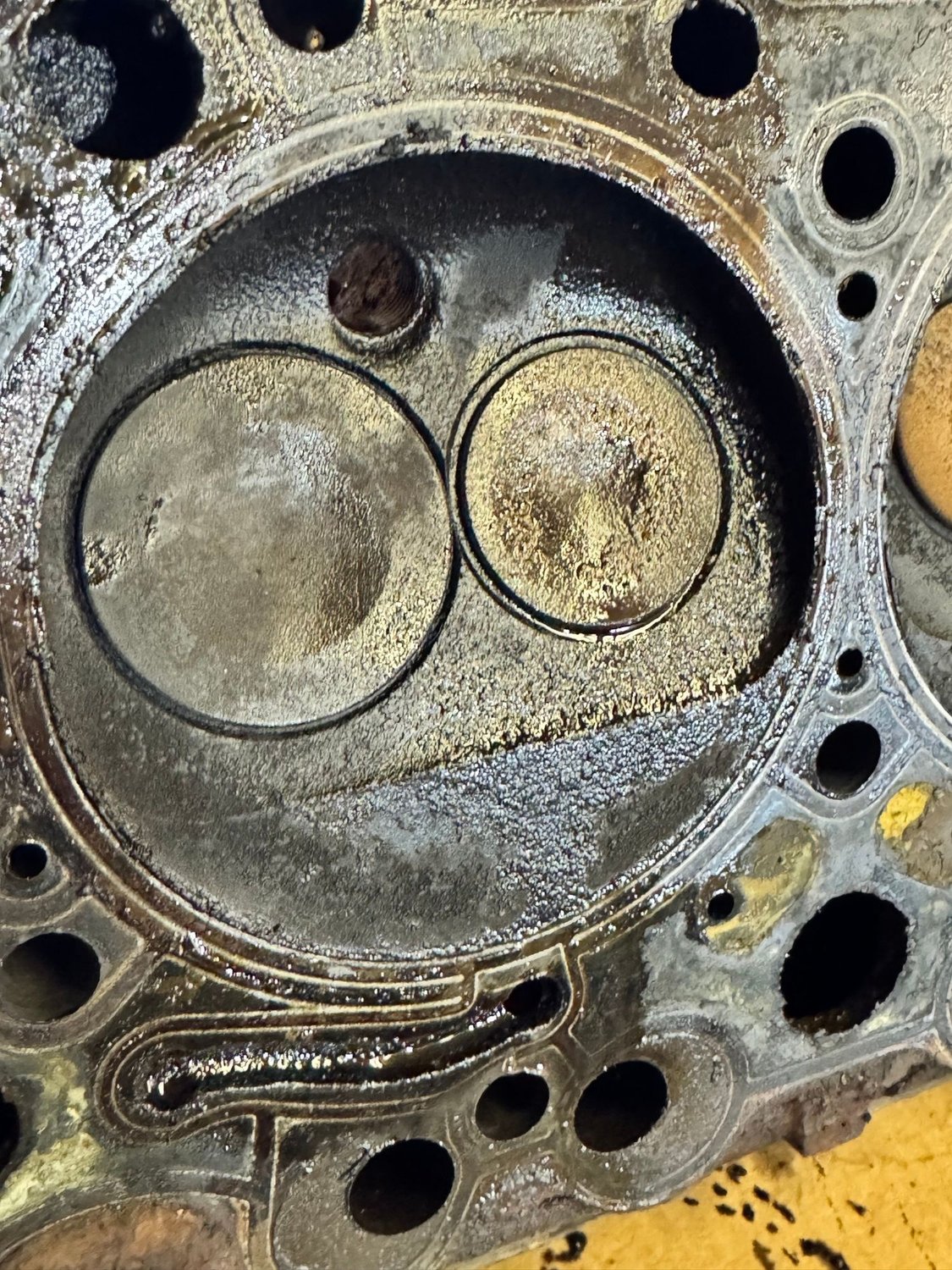

The combustion chambers and valves sre in decent condition
The combustion chambers and valves are in decent condition

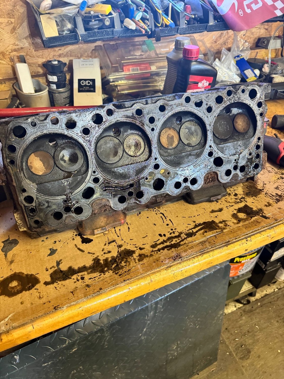

Both heads off!
Both heads off!
