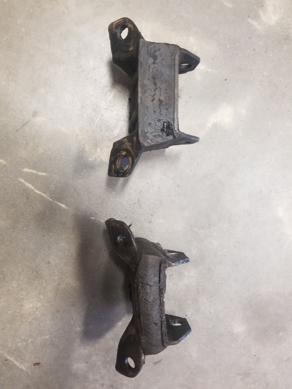

thanks, that's a good start for me to have a better idea what I'm in for. I was planning on changing the motor mounts anyway so now is a good time.

If you need/plan to replace the mounts, this is a good time. I have a '68 4-4-2 in which I added Hooker 3902 headers. These headers' end bolt mounting points are slots, rather than holes. My understanding is that the 400 block is the same as the 455 block in this dimension. I had to drop the starter, but the oil filter adapter did not need to come off, just the filter, and that was just for wiggle room - it would fit and go into position with the filter in place, but the extra room makes it easier to finagle into position. After deinstall of the exhaust manifolds, replace the rear bolt into the head but don't tighten it down. This way, upon installing the header from below, you can slide the header's bolt "slot" onto the bolt, thus temporarily hanging the header in place until you get back above and install the other four bolts (each side).

If you remove the starter and oil filter housing, the headers will go in with the engine on the frame mounts. You need to get the front end of the car pretty high. I have had solid mounts on my car for probably 20 years, rubber mounts might change things.

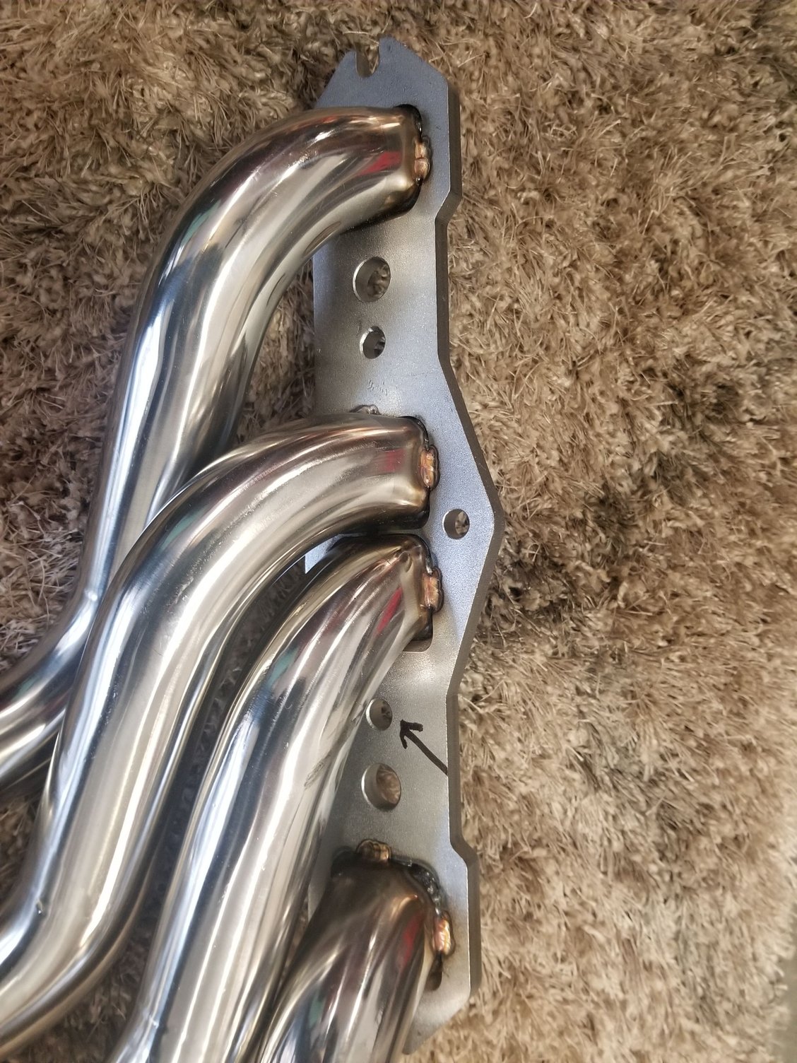

There is one bolt that I don't believe can possibly be installed. Will that be an issue or am I missing something. The tube is just in the way. It is the same for both sides.

If a bolt will not go through the hole with the header on the bench, you need to install a stud in the head that will allow a nut to be used instead.

That situation is common on Olds headers, as stated above, use a stud, find (and/or adjust) a length that won’t gouge the tube when things are tightened. Start bolts in the front and back holes to support the weight of the header. You then have to sort of “hover” the header off the head so there’s juuussst enough room get the nut (that your already holding against the flange) started on the one or two threads you expose. Once you go through the digital gymnastics of starting the threads, the nut can be spun on, a thread or two at a time, with fingers, a pocket screwdriver or an open end wrench. A small magnetic pickup tool can also be a boon when starting the nut or positioned as a “catcher” if the nut tries to escape.
Old Jan 6, 2022 | 10:27 PM
Posts: 6,095
You can put a bolt in that spot, if you know the trick.
Install the 2 end bolts loosely, so the headers isn’t right up against the block. Slip the bolt into position, it will thread in.
It helps to have a few cheap wrenches to can bend and modify for these projects. Good luck.

Well I checked and the flange is 3/8" thick and with a little grinding so I could angle the bolt in the longest I could possibly get in is 3/4" that would give me 3/8" of thread into the head. Seems like not much but any thoughts as to if that is adequate? Or I'll pick up some studs and pull the header. It's always easier the 2nd time doing something.
Steve
Old Jan 7, 2022 | 09:05 AM
4+4+2=10's Avatar
Posts: 618
From: south central Kansas
3/8" into the head doesn't sound like enough, especially when to take your gasket thickness off of that. You need to remove the header and get it out of your way.
I would find a stainless bolt with at least 2 inches of thread and install it into the hole using red locktite. Using a bolt allows you to torque it tight. Then cut the bolt off with a cutoff wheel leaving about an inch of threads sticking out of the head.
Now you have an installed "stud" that is the correct length and will not back out on you later.

What I do, is I oblong that hole, then put the header on, and start that bolt first, then make it tight enought, to where you can still slide it back. Ones the bolts all the way in you can put the rest of the bolts in, and the you should be able to put a wrench on it to tighten. I also slot the gaskets, so when the bolts are on, you can slip them on place . makes it easier than trying to put bolt, headers, and gaskets on at the same time.

By all means cut it off where you need too. With a 3/8 flange plus a gasket, you would have about 9/16" of the stud poking through the header flange. If a 3/4" bolt will go in the hole as is, I was making a SWAG on the stud length that would work.
Old Jan 7, 2022 | 10:03 PM
Posts: 6,095
Header bolts are 3/8 diameter. I believed the rule of thumb is you need at least the same thread engagement as thread diameter. Think about the thickness of a 3/8 nut, as long as you have similar thread engagement in the head I would think your good. Besides, these are headers. If you crank the bolts tight enough to pull the threads from the head, you will have already distorted the header long before. Headers aren’t structural, as long as they are tight enough not to leak, and tight enough not to come loose your good
