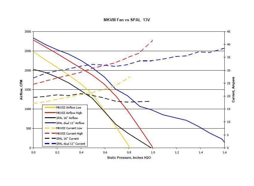

The C5 is an incredible machine but its fans are weak. We are surprisingly talking 1600 CFM for both fans combined
For comparison the legendary go to mod for hot rodders when wanting to go with an electric fan is a Lincoln Mark VIIIs. Its singular fan moves 2700 CFM.
P.S. Thank you for such a thorough post. Makes it so much easier to try and diagnose an issue.

Matt69Olds, Fun71, Retro, I hear you guys with regards to insufficient cooling capacity. Makes sense, but his checklist indicates it is sufficient.
What's a screaming eyesore to me is the insufficient fans. He has a 60 over big block that's turning 4200 RPM or worse at 75 MPH. I know he mentions 3500 RPM at that speed but that doesn't compute.... Unless he has a ridiculously tall tire...
Maybe it is the air dam effect that you mention Matt, and maybe its what SuperChevy mentions here. "We once saw a Pro Street '66 Nova electric fan that was wired backwards. It somehow ran OK in town but it overheated on the highway. Its puller fan was pushing air, causing almost no air to pass through the radiator." http://www.superchevy.com/how-to/eng...g-system-tips/
One way or the other it comes out as fan related...

About the fans: We ended up going to electric fans after trying two different fan clutches AND a solid fan spacer (with the factory shroud in place).
We decided to go with the C5 fan assembly because it was an almost perfect fit, and we figured that if it could cool modded 'Vettes on the race track, it should work fine for a mild Big Block.
I'm well versed with the MK VIII/ Mustang fan; I have one in my '89 Trans Am. I don't like how much power it pulls, though.
I figured that two smaller fans (each with their own relay) would be better.
The fans' polarities are correct; I made absolutely certain of that when doing the wiring, because I have seen incorrectly wired fans cause all kinds of weird problems.
With that said, I don't think it's a fan issue, because this is only happening at highway speeds.
Wow ok there goes my idea. Sorry pal I thought I was onto something.
I agree with you I would've figured the C5s fans would be kick ***. I had no idea about there rating till I looked into it just before posting. For some reason it jumped off the page at me. Maybe its my bit of distrust towards electric fans. Have a friend with a built 454, spent plenty on the cooling system and also has complaints about the car running too warm.
In any case I was wrong as this is not the issue.
