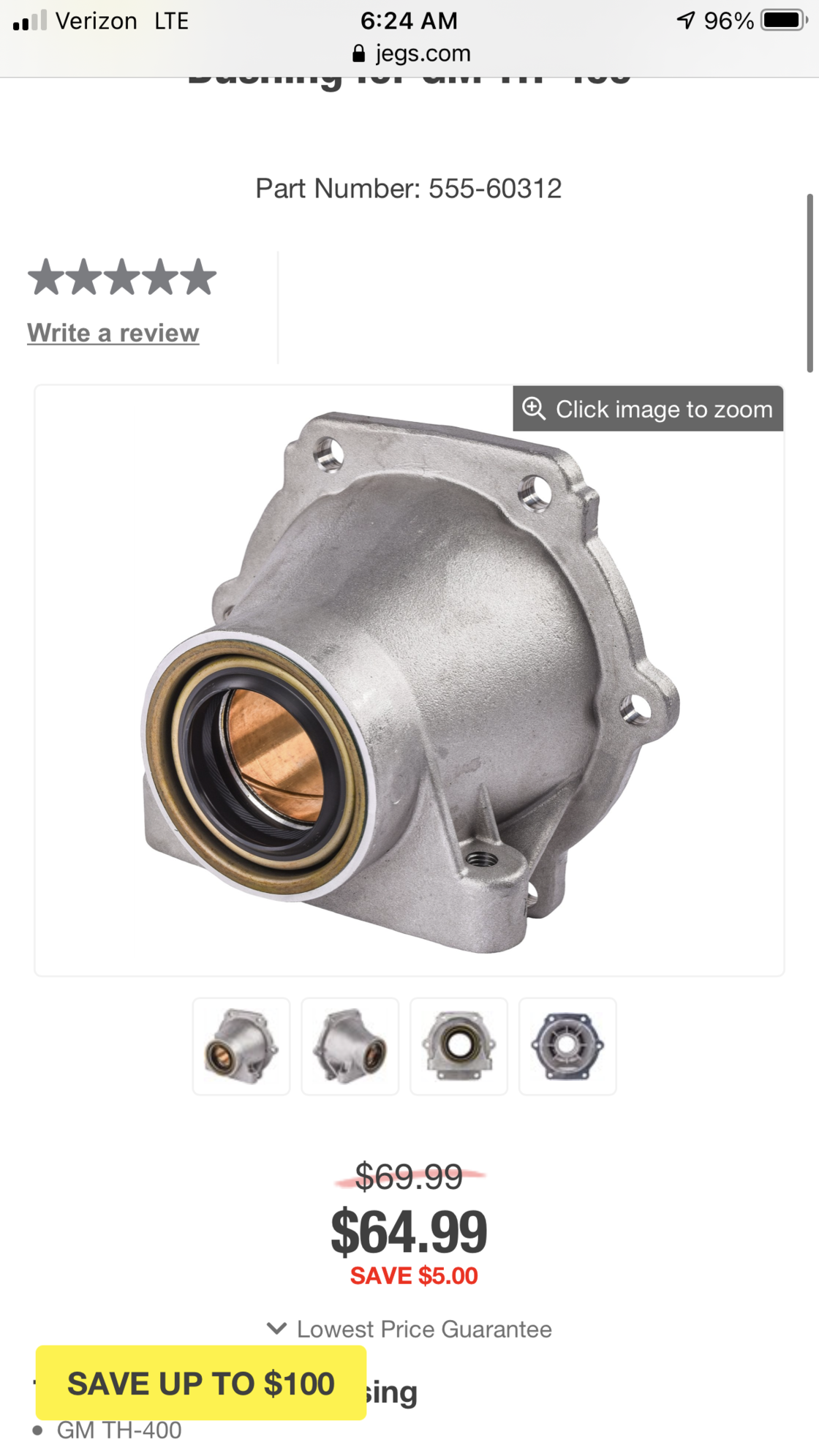

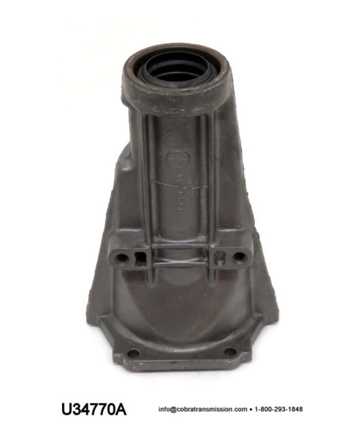

Old Feb 22, 2021 | 10:27 AM
Posts: 6,095
This is a short extension housing.
This is a long housing.

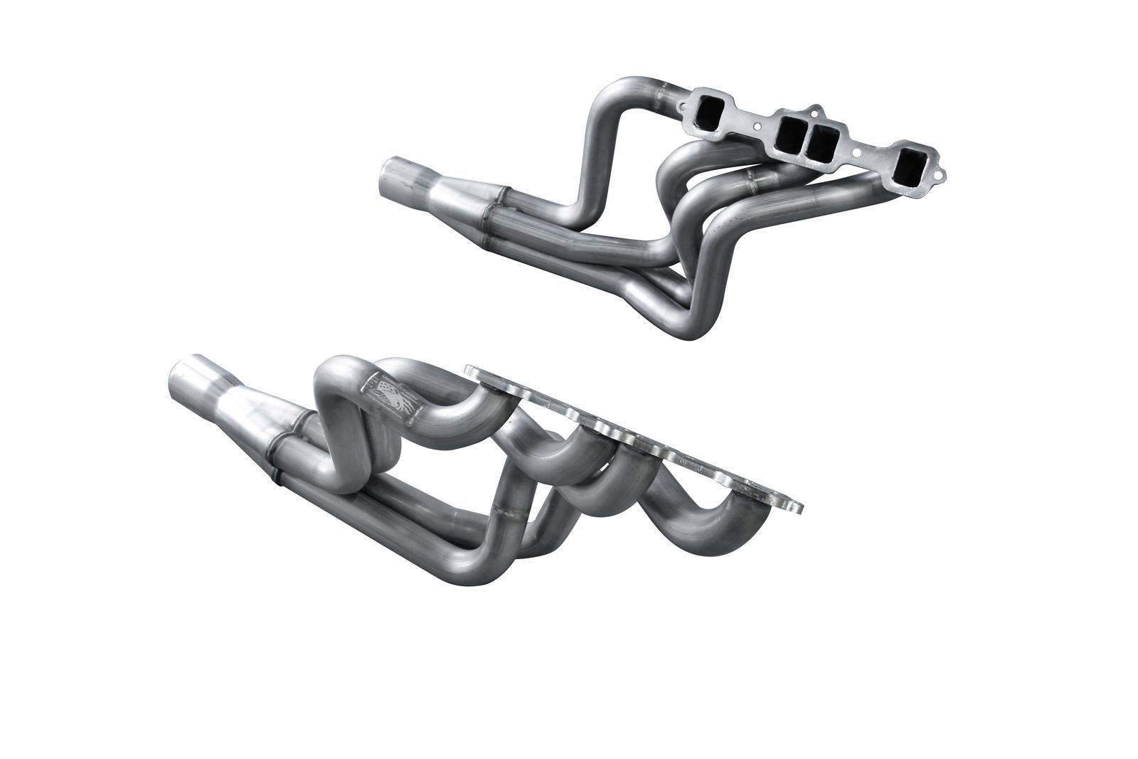

If you can find a stamped P/N on the header flange or one of the tubes, that's probably the only way to tell for sure. The Hooker BBO headers for a G-body have one tube that goes around the outside of the frame on each side.
ARH sells BBO headers for a G-body that fit inside the frame rails but there is other collateral damage, like the need to trim the trans bellhousing and use a mini starter.
