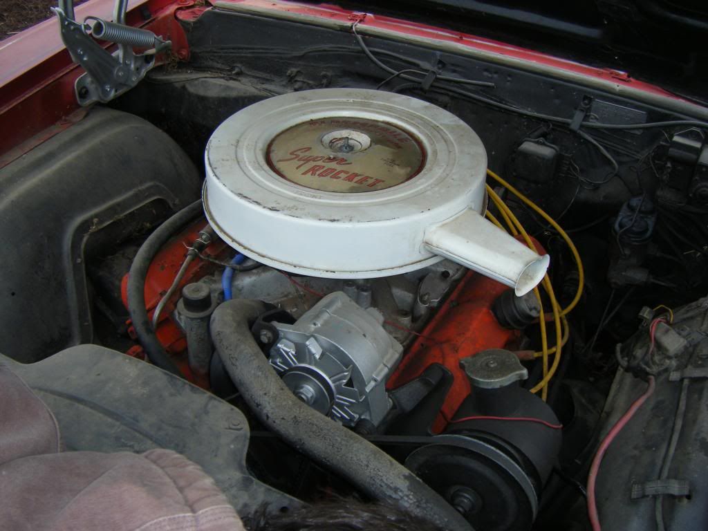

First post so I may not be able to attach a photo. We are trying to get a '67 Cutlass bought. My understanding is they never came with a 425 but it's not that hard to do. The guy that owned it has passed and his mom doesn't know what's in it. I don't know an olds 425 from 350 so need some help. Thanks.
The intake looks like a BB torker. And yeah, trying not to just go by the air cleaner. That just too easy.
http://i124.photobucket.com/albums/p...ps1e9f20bd.jpg

Personally, I can't tell you with absolute certainty from that angle, but between the width of the intake and the "hat" style oil fill cover, it looks like a 425 to me.
And, you are correct, the 425 was never installed in any A-body car by the factory.

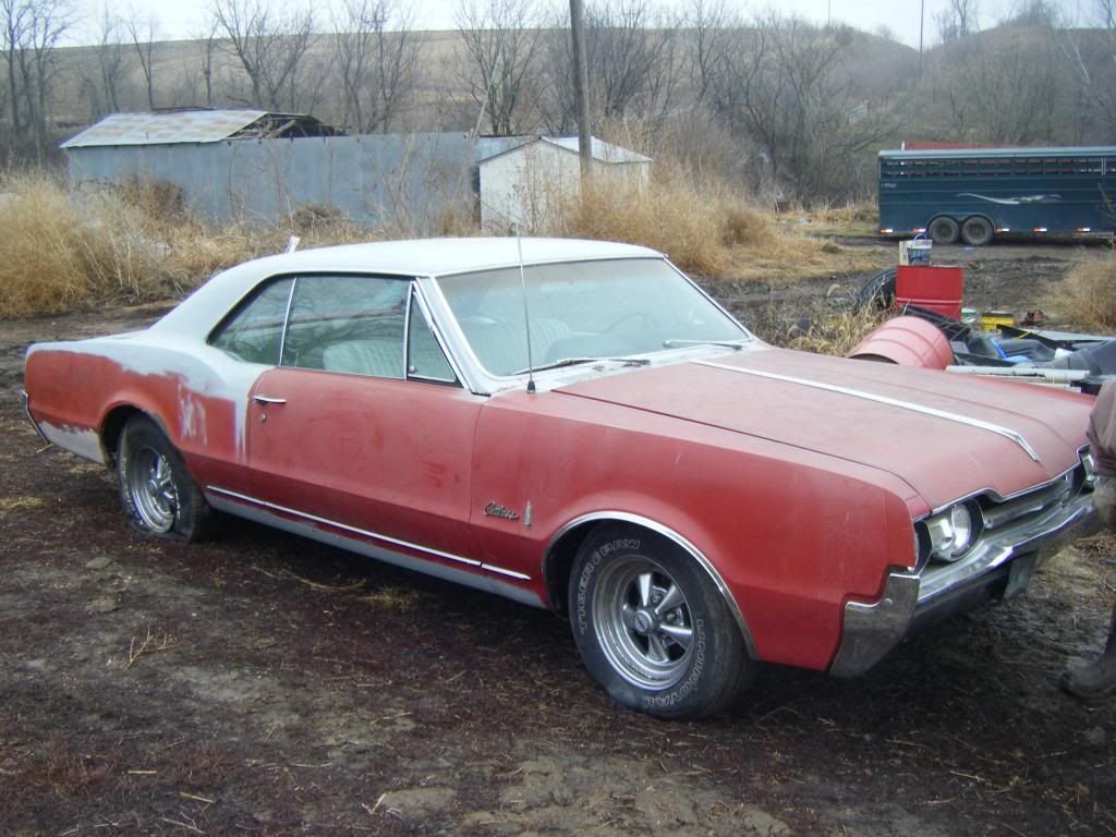

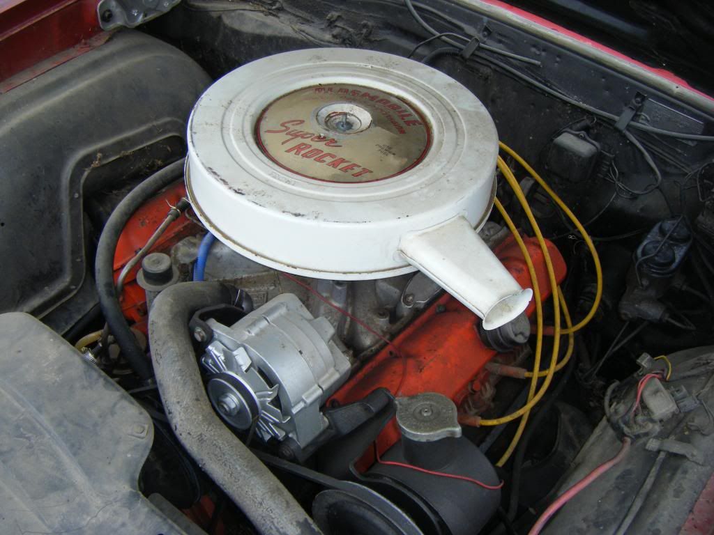

Thanks a bunch. The reason I ask is the dad says it's a 350 so it's not the correct engine either way. This is for my wife and she loves a BB. She's fine with a 350 but this just makes it a little better. My understanding is that this was a great engine. Here's the same angle but a little different and a body shot. The poor fellow got the hard parts done and then passed away.

Looks like a nice car.
To know more specifically about the engine, we would need to know the large cast numbers or letters on the heads (front of the driver's side, back of the passenger side), which should be B or C for an original 425, and the large cast number and letter facing up on the front of the engine, above the water pump.
There should also be a unit number on the front-facing surface of the passenger side head, unless the heads were swapped, in which case it would be on the back of the left, facing the firewall.

A Torker 350 or small block intake does not exist so if a torker is on there it is a BB of some sort but a 425 would be a D block, it could also be a G or E block 400 or f block 455. Since the air cleaner resemples a 66 67 425 unit it is likely the engine is a 425.

Oldsmaniac beat me to it. That looks like a late model Torker (W/ EGR) which was only made for the BBO, 400-455. If you still want to know for sure post the numbers/letters on the block under the alternator.

First, the 1964 330 cars are unique and don't apply here. The 1965-67 cars all use the same brackets. Alternator location is dictated by A/C or not, and for the 66/67 Calif cars with A.I.R., there's a unique set of brackets (also does not apply here). The 68-up cars use a completely different set of brackets from the 65-67 cars.
The setup in the pictures is the correct alternator location for a 1965-67 car with A/C (of course, the A/C bracketry is gone). This is a non-A.I.R. set of brackets.
As for what this is, rather than speculate why don't you just check the block casting number above the water pump?
