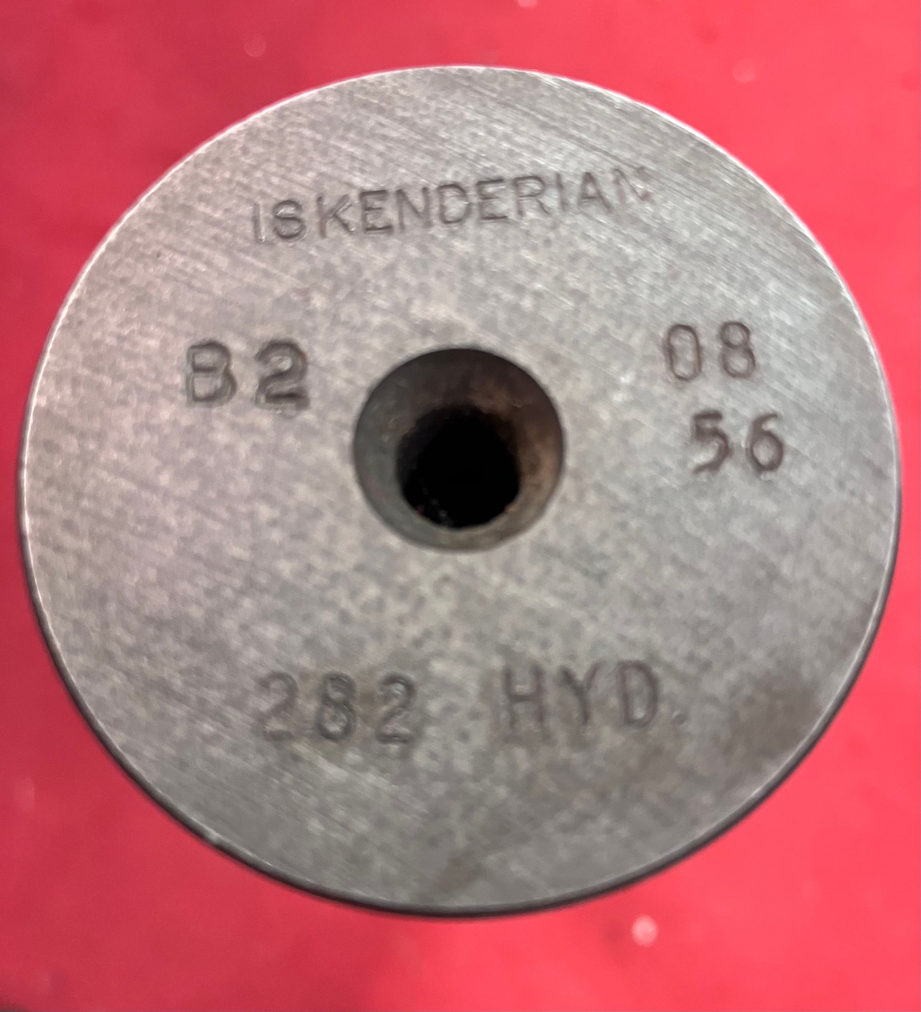

Hi, I am wondering if anyone here with knowledge of camshafts for 371 engines can help me make the right choice. The engine which the camshaft will be installed will be completely rebuilt.I have two different camshafts.One is an ISKENDERIAN marked B2 0856 282 HYD.

The "Isky" (Iskendarian) appears to be a 282 degree hydraulic lifter cam, for use with hydraulic lifters.
The other cam (Almquist Engineering) is unfamiliar to me. There is mo way to know if its for use with hydraulic or solid lifters. Others may chime in with more information..
Define "work smoothly in a 371 engine". I would say that a 282 degree (duration) cam was on the racier side back in those days. It should work fine. However, we don't know what the valve lift would be. You'll need to partially assemble to check push rod length with hydraulic lifters. There is a chance you may need adjustable rocker arms for your application.

Looking through my old Isky catalog it loos like all of their 282 cams are described as having a "lopey" idle and requiring performance upgrades like headers etc. If you are looking for a stock type idle I would say that is not the cam you want to use. You can call them to be sure but I think that is what the answer will be.

BillK is correct, Isky should be able to answer questions about their cams. 282 degrees duration was more radical than "stock" back in those days. Valve lift was probably under .400". The J-2 cam was probably not much different than any other 1957-58 "371" cam.
