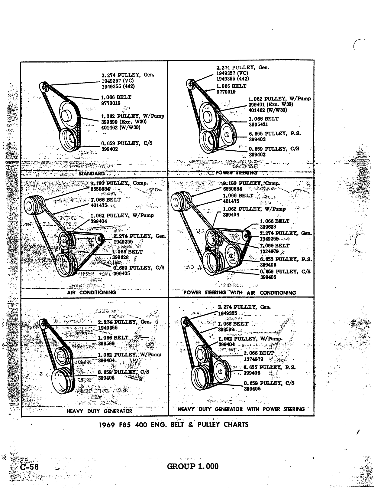

1969 442 400 V-Belts
Does anyone have part numbers or recommendations for the V-belts?
I need to replace all three.

Thank you!
