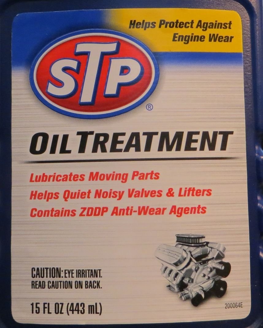

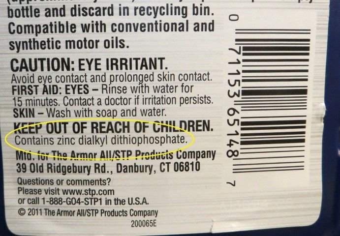

As far as oil, I don't bother looking for oils with the zinc additive (ZDDP). I just use whatever 10W40 is on sale at the local auto parts store and add a container of STP oil treatment each time I change it. The STP has the needed zinc.

Thanks for the info!! I'll start using the STP. Sounds like good stuff. The time and effort you took to reply to my question is very much appreciated!!!

A zinc additive is a good idea.
As Jaunty said, STP should work fine.
I prefer to use Lucas Break-In Additive, which has a metric s__t-ton of ZDDP -
I use about an ounce per oil change, and one bottle lasts me a long time, for about the same price of the single-use bottle of STP, but it's all good either way.
