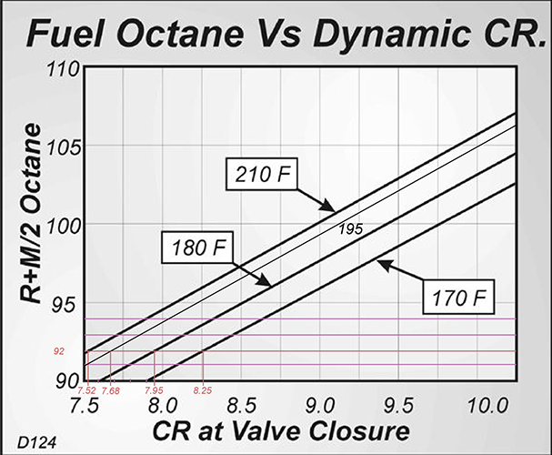

The airflow you get going down the highway at 60-70 mph is pretty intense and no clutch fan is going to produce that type of airflow as highway driving would.
A high-performance 455 will run hotter than a stock 455. A 0.60 over bored cylinder will tend to run hotter than a .30 over or stock bored cylinder.
If the cooling system is up to par. A 160F t-stat will typically make the engine run 170-180F in moderate traffic and heat and 190F in heavier traffic and heat.
455s don't come with knock sensors and if the compression is hovering around 10:1, you can detonate, especially if running hotter.

Your chart references dynamic not static compression, big differences. Engines are designed to run in the 200-210 degree range. In fact the viscosity ratings on engine oils are all based on the engine being in that 200-210 degree range. The thermostat will have nothing to do with that temperature. That, as Joe stated, is determined by the radiator.
When you say "engines" are you referring to every single engine produced? The Olds 455 engine? GM engines? Chrysler, Ford engines?
Each manufacturer has their own specs. Not all engines are created alike and some like to run cooler than others and some like to run hotter.
Dyno runs on the 455 with iron heads always showed me that they like to run in the 180F range for peak HP. Once it hits 190F, the HP #s drop. Once it hits the 210F range, HP drops even more and detonation begins on higher compression engines. That's a 455. Not all engines respond the same to temps. Modern Chevy LS aluminum engines like 200-210F for peak HP but they are aluminum and are engineered TOTALLY different than a 455.
