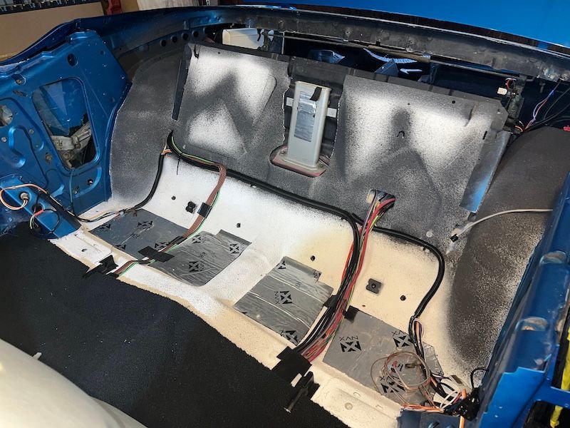

I sprayed the floor in my '72 convertible with LizardSkin which controls both heat and sound and used peel-n-stick CLD from NVX in the firewall, cowl areas and back seat areas. I also lined the backside of the kick panels and ashwell panels with 1/2" carpet padding. It may have been a bit overkill, but the floors don't get hot and the road noise and muffler rumble coming from below are not intrusive. Of course, driving with the top down at 40-6-mph the window noise is substantial.
The LizardSkin is sprayed in 2 steps; the sound control is applied first and the ceramic temp coating is sprayed on top. It's kind of pricey and you need the right spray gun to apply it properly but I think it was worth the effort for my project. Here's a pic of me car.
Rodney
The dark gray is the Lizard Skin sound control material, the white is the ceramic thermal barrier that is sprayed on top of the sound control layer.
