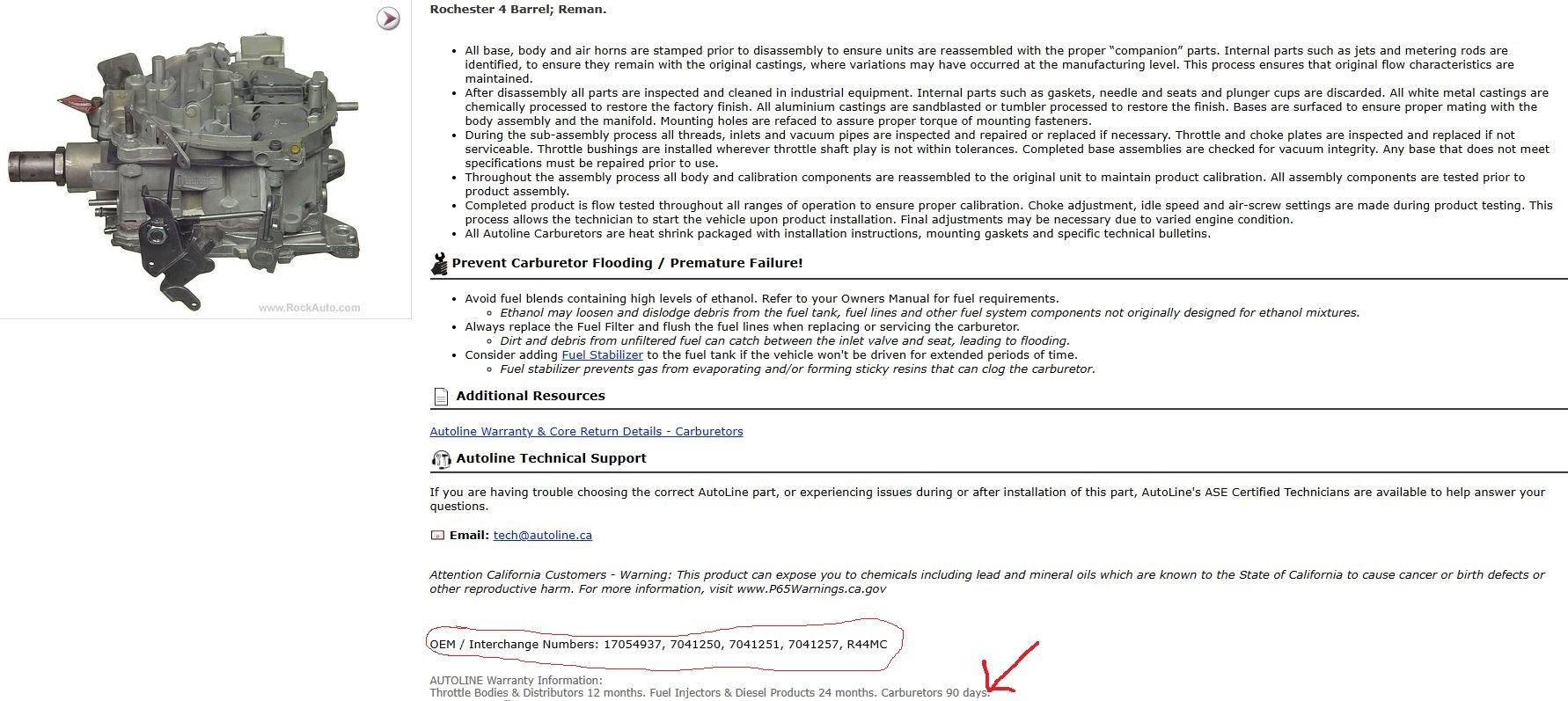

I ordered what was for a 71 olds with 455....
See interchange model number on pic, 90 day warranty so I give it a try !
Upon receiving, I'll check for rods and jet number, it's suppose to be in relation to the casting number.....will see.

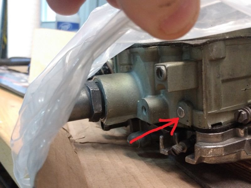

Hi again, I just receive my Rockauto carb (the rebuild is by Autoline)
Advice please the casting number is 7043250, I haven't unpacked it yet, but
there's a missing vacuum port in the front (ported) see pic. Why is it missing ? It's 1973 number but...
On the last picture, this one is from Quadrajet power web site with the same casting number but with the correct front port.!!
Is it really for a 455 ?
Thanks guys

That isn't the casting number....7043250 is the Model Number. I can dig around a bit, but others may join in before I get to it, I believe that is a 1973 Quadrajet used on the Oldsmobile 350 cid engine - not the 455 cid. However, w/ that said, it most likely can be jetted to accommodate the correct jets & rods for a 455 (I think). I believe there "should" be the additional ported vacuum on the 7043250. A Quadrajet carburetor basically consists of three "tiers", from the top down: air horn (top), float bowl assembly (center section) & the throttle body assembly (bottom section). During the periods roughly equating to 1969 through 1972 (give or take maybe several years), you often will find Quadrajets which can easily be swapped between engines. Bear in mind, you can also find re-builders who use the air horn from one model number to use on a completely different model number e.g. swap the air horn of one model year onto the float bowl assembly of a different model year. That "port" which is missing may have been a float assembly used on a different model year - I am not sure. As emissions standards changed during these years, different float assemblies either did or did not maintain the same vacuum port sources. I know a fair amount, I'm not an expert - I'd have to look items up.
Old Oct 19, 2023 | 03:16 PM
Posts: 26,056
Post #6 in this thread lists the correct rods & jets for the 7043250

A 1971 455 4bbl Quadrajet used part number 7041251 a 1971 4bbl for a 350 would be 7041250. I'm going to hold off on making a suggestion as to the applicability of using the 7041250 (350 cid) on your 455 even if you were to accommodate the correct jets & rods. There are better more informed & knowledgeable members who can provide you with better guidance. Be patient others will chime in.

  #39
Posts: 26,056
A great source to find Delco GM carburetor build sheets is the URL link below. There are many books, pamphlets, etc. - but, I've found this site to be excellent & many are unaware of its usefulness. Click on the "GM" drop-down menu and browse by year. Have fun (sorta). You can d/l any of these .pdf files.
GM Carburetor Build Sheets
Old Oct 19, 2023 | 04:45 PM
  #40
Posts: 15,409
That missing port is the ported vacuum source for the distributor vacuum advance on my carburetor (7041250) . It is capped off and I have the line for the advance canister connected to manifold vacuum. I wouldn't send the carb back just for that missing hose nipple - check as much as you can and let the overall assessment guide your choice to send it back or not.
