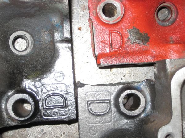

What I will ask now is the heads the "D" heads and you have provided the part number for the car which we can verify.
How are the heads identified as a "D" head?
Thanks
Old Dec 15, 2019 | 08:34 AM
Posts: 50,828
Oldsmobile heads have an identification number or letter near the number one and number eight spark plugs. The correct heads for a 1968-69 W-30 would be "D" heads. The casting number above the center two exhaust ports is 400370. The engine obviously isn't "original" if it's been replaced.
