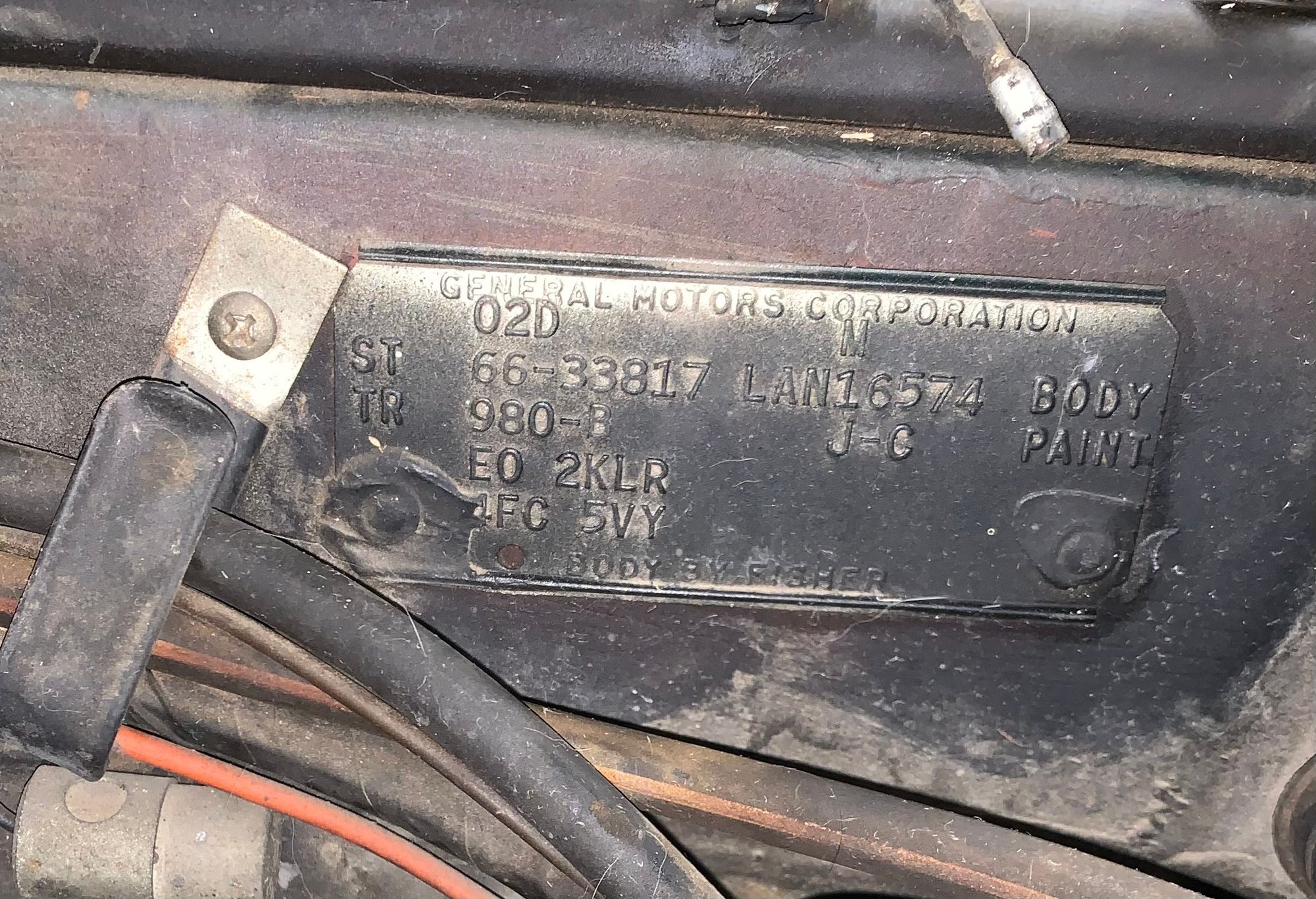

I have a 1966 Oldsmobile 442 that my Dad bought brand new. I’ve been researching the cowl tag, as I have been told my car was not an actual 442, because it has a chrome strip down the center of the hood. . I do have the “V” on the cowl tag so I know it’s a 442. I’ve researched all the numbers till I get to the last two lines starting with the E. I’m not much of a car guy, so any help would be appreciated.
Old Jun 29, 2023 | 07:49 PM
Posts: 50,801
The last two lines are the ACC (accessory) codes. There were five groups of code letters designating options on the car.
Group 1
E = tinted windows
O = two tone paint - specifically the trim that separated the paint colors (note that the J-C paint code shows Forrest Mist (J) lower and Provincial White (C) upper colors)
Group 2
K = Firewall punchout for air conditioning
L = mounting hole and plate for four speed floor shifter
R = rear speaker
Group 4
F = outside remote control mirror
C = chrome window sill moldings (RPO B85)
Group 5
V = 442 option (RPO W29)
Y = deluxe seat belts
The hood with the chrome spear is not original to the car.

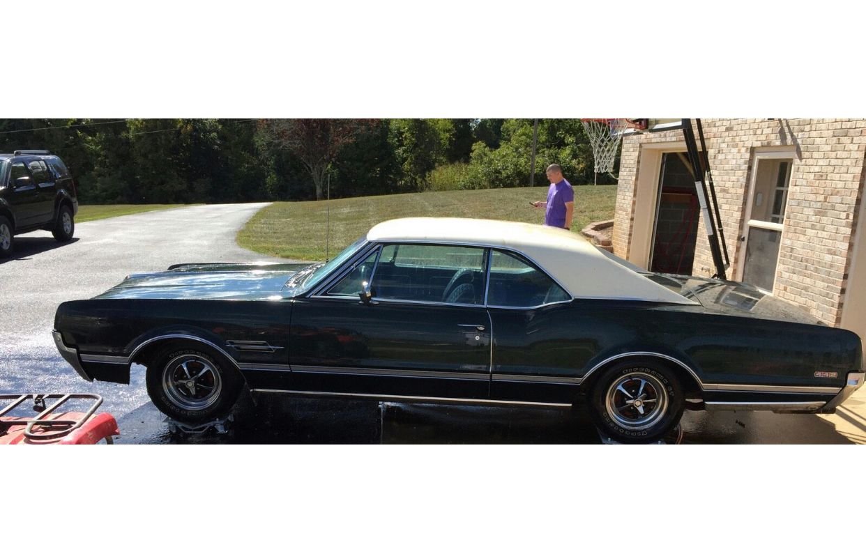

I really appreciate the information. The chrome spear, I’m really confused about. I wish my Dad was here to ask about this. Could the spear have been a dealer add on?
Old Jun 30, 2023 | 06:08 AM
35tac's Avatar
Joined: Feb 2015
Posts: 1,260
From: Medina, Ohio
Either hood was replaced with a Cutlass hood or someone added the spear. Regardless it seems to be a real 442. Like to see some pictures.

Thanks…here’s my 4-4-2…
Old Jun 30, 2023 | 07:41 AM
35tac's Avatar
Joined: Feb 2015
Posts: 1,260
From: Medina, Ohio
Bill, very, very nice. I have seen a number of this paint combo in one Olds or another. We have here in a Tri-Power 66 with the same scheme with a white interior. Love those 66's.
Wayne
Old Jun 30, 2023 | 10:25 AM
43BILL's Avatar
Joined: Jun 2023
Posts: 8
From: TN
Thanks Wayne…that’s the reason this car has stayed in the family. It was a daily driver until 1977. The rest of the time it has been stored many places, including a barn. I was the last driver for 2 years, and I could not part with it. I was too young to remember my Dad doing some changes to the car, about the only thing I remember is that he changed the wheels to Magnum 500s.

The 66-33817 on your cowl tag is the year and model, and 3817 is the holiday coupe.
Your car has some interesting trim on it. The lower rear quarter and rocker moldings did not come on the car. They were only found on the F-85 Deluxe
Old Jul 1, 2023 | 02:51 PM
43BILL's Avatar
Joined: Jun 2023
Posts: 8
From: TN
Thanks Rocketguy…that even adds more questions. Did my Dad have this done, or was this a dealer add on for whatever reason. The car has never been in a crash, so a lot of questions with probably no answers. Thanks…Bill
Old Jul 2, 2023 | 01:51 PM
Posts: 12,796
It certainly wasn't a dealer add on as it is incorrect for the car, just like the hood.
If I were to see this car out in the wild, I'd consider it a bad clone, with a cowl tag transplant. However, two things are against that, which are we are assuming the car's history is as you have told it, and being that egregiously off with the duplicated chrome, yet being spot on on getting the two tone right to the tag, is improbable. Perhaps your father wanted more bling and had the parts added after purchase.

All from those two pictures?
As for the cowl tag, by the looks of the sealer on the rivets and matching patina I disagree.
Old Jul 3, 2023 | 01:04 PM
Posts: 12,796
It helps to take my entire point in context, not to pick and choose specific bitching points.
