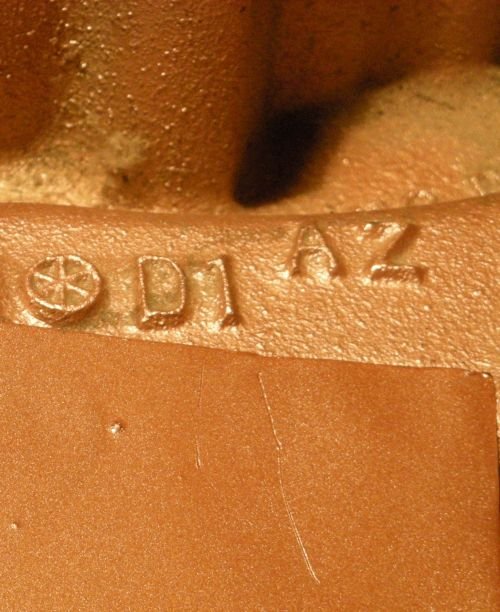

This thread has gotten almost as much attention as one for engine oil. I realize that the original question was for 1968, and that by itself may void my comments, but I thought that I'd post some pictures of my experience with the Rust-Oleum stuff. My comparison was to 1965 & 1966 engine components that have never been repainted. Color comparison is a slippery slope. Light color and angles matter. Surface texture matters. "Close" is a relative term. Compared to the sun, the Earth's moon is close.
The first shows a close-up of a sample of the Rust-Oleum on a relatively smooth piece of sheet metal against the front surface of a rocker cover on a 1965 400 engine that has never been repainted.
The next two show the same sample against the intake manifold of a 1966 400 which has never been repainted.
All photos were made under the same 3200K photo-flood lamp with the same Nikon L12 camera with no filter. No editing of the photos was done except for cropping/resizing. The smooth rocker cover appears different from the rough surface of the casting. As you can see even the appearance of the sample differs between the images. It was the same sample. Hence, detecting a "close" match may be difficult. I apologize for any misunderstandings I may have created. In the end, just getting something that we like may bring adequate "happiness".
