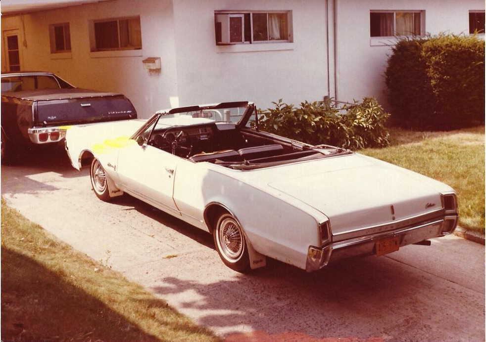

Thanks Oldsmaniac! Although in jest, you asked why anyone would buy a 67? Legit question, here's a legit answer. I remember every car my dad had when I was growing up. My favorite by far was the 67 Olds Cutlass Supreme he bought new when I was 8. It was red on red, with the 330 in it, bucket seats, and the center console shift. Boy was it beautiful! I've wanted a 67 Cutlass from that day to now. Just thought I'd get one up on old dad by getting the 442 package, I know he'd approve.
My story is similar, pop bought a used family car. It was a 67 Supreme 4dr. When I found out there was a 442 that looked similar wanted one.

Oldsmaniac, that's cool how your story is very similar to mine! Funny how so many memories from our childhood are so vivid like they happened just yesterday, yet I can't remember what I ate for dinner two days ago. Hey, is that your car in the pic? It looks really awesome!
It is a vintage picture of my 442 and my pop's 4dr Supreme in front of it. I still have mine. Picture is from 1976. And this is what you could get then for 700 bucks.

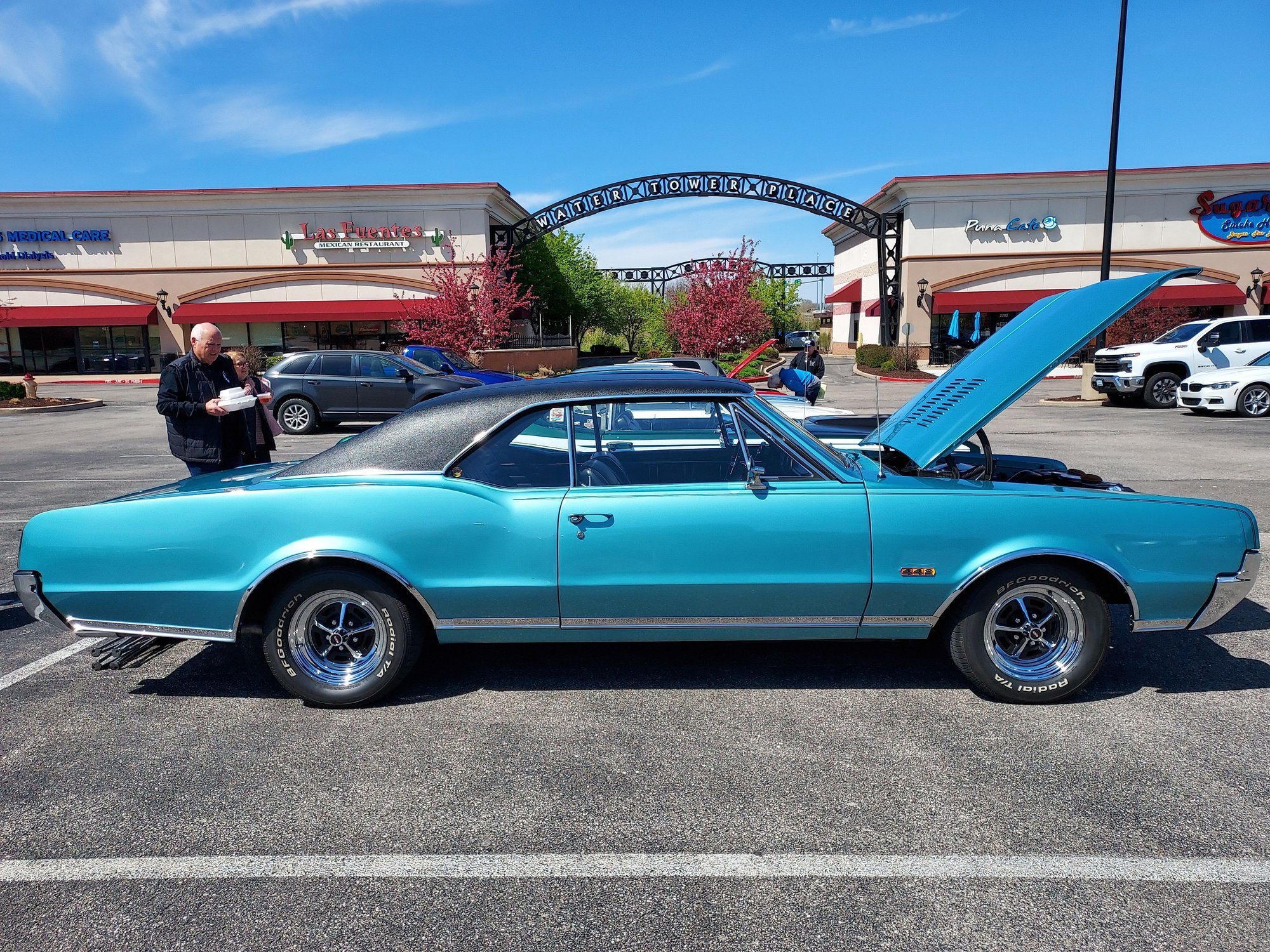

Well, I've owned my car for over 3-years now and it has been both a gem and a joy. This past season I had it out to a total of 33 events that included 15 judged shows and 18 non-judged cruise-ins. I put a seasonal record of 1600-miles on it last summer. I've become a regular on the St. Louis car scene, and I am a member of the St. Louis Archway Oldsmobile Club. This wonderful car has become such a joyful part of my retirement, whether it's taking it out to an event or tinkering with it in my garage. Here are some of my favorite pictures from this past season:
At the Archway Oldsmobile Club's Fall "All Oldsmobile Show"
At a judged show in St. Genevieve, MO put on by the Knights of Columbus
An early arrival at a large cruise-in put on monthly by a local church
I know you guys like to see engines. Original "E" block and "C" heads (ported and polished)
A pic of the Show Sign I created using reproductions of vintage '67 4-4-2 advertisements

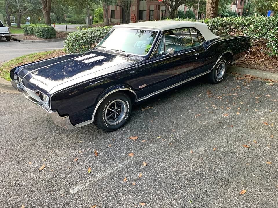

Much appreciated Chris - it should be fun...a documented, verified, real 442 with a/c, power windows, locking diff - only thing not original on this 115K piece is the repaint (correct midnight blue, done in the late 90s), the vert top (correct white, redone in 2019), an Edelbrock carb (comes with a Q-jet but not the original 7027157), and the SS1 wheels (it comes with the original steel wheels and simulated wire hubcaps). Researching seat cover and carpet kits and will dive into that and some weatherstripping that needs to be replaced (trunk seal, vent windows). Maybe BFG Silvertown Redlines to approximate original. Otherwise I just plan to drive it and enjoy it for now! I'm in NW GA. And below was my first car in high school, so I'm reverting to my childhood! LOL...

Herkguy - if you're talking about my new-to-me Midnight Blue ragtop, thanks...exactly the idea! If you're talking about Dream67Olds442's, well, I'm not worthy! LOL...
