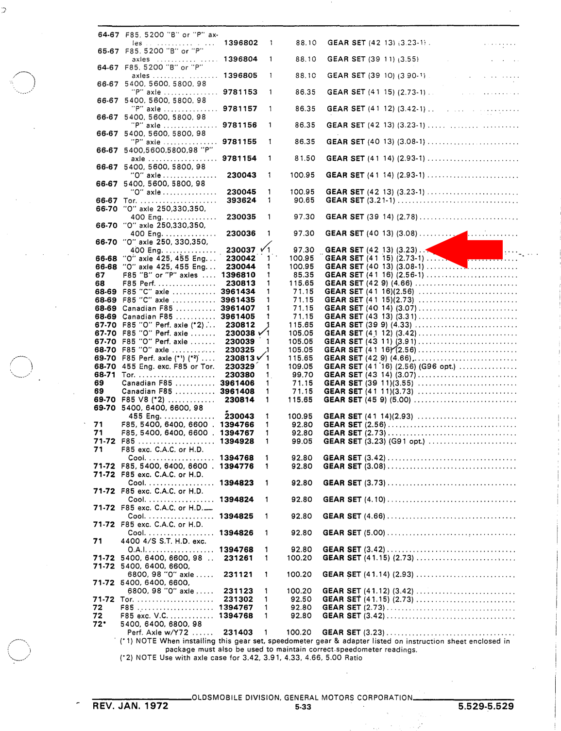

Old Dec 16, 2019 | 09:24 PM
JLawrence's Avatar
Joined: Dec 2019
Posts: 136
What axle do you have, Type O or Chevy 12 bolt? If it's a Type O, 3.23 gears may not be easy to find. Keep in mind that you'll need to change the carrier to a 3-series; 3.23 gears won't physically fit on a 4-series. You might want to consider 3.42s, which WILL fit on a 4-series carrier. The difference from 3.23 to 3.42 is negligible as far as highway RPMs are concerned.
olds 3.42 are like 3.41 if I recall but 3.23 are not 3.23 they call them that they are 3.15s or something like that. I just made that swap but no drive time yet
Old Dec 17, 2019 | 12:13 AM
svnt442's Avatar
Posts: 4,293
From: Palm Bay, FL
Not really sure where you got this information, but it's incorrect. Take a good look down the left side for the gear ratios and the tooth count on the ring and pinion. A 3.23 is a 3.23.

Old Dec 17, 2019 | 09:13 AM
JLawrence's Avatar
Joined: Dec 2019
Posts: 136
from doing the math with the gear count
But not sure how I screwed it up i used my phone as a calculator
I'm going to have to pull the cover and do it again at only sucks because I just put new fluid in it
Old Dec 17, 2019 | 09:15 AM
Posts: 50,799
The Type O 3.23 gears have a 42 tooth ring gear and a 13 tooth pinion. 42/13 = 3.230769
Old Dec 17, 2019 | 09:18 AM
JLawrence's Avatar
Joined: Dec 2019
Posts: 136
but from what I still have chicken scratched down is 41 and 13

The others are spot on.
Old Dec 17, 2019 | 09:45 AM
Posts: 50,799
From the parts book:
Old Dec 17, 2019 | 09:51 AM
Posts: 50,799
Originally Posted by VC455
Dividing gear counts and comparing to nominal ratios, two gears differ by -1 in the third significant figure:
  • 2.78 is actually 2.79
  • 4.66 is actually 4.67
39/14 = 2.78571, so yeah, someone didn't round off properly.
42/9 = 4.666666666
Heck, even the IRS lets you round to the nearest dollar.
