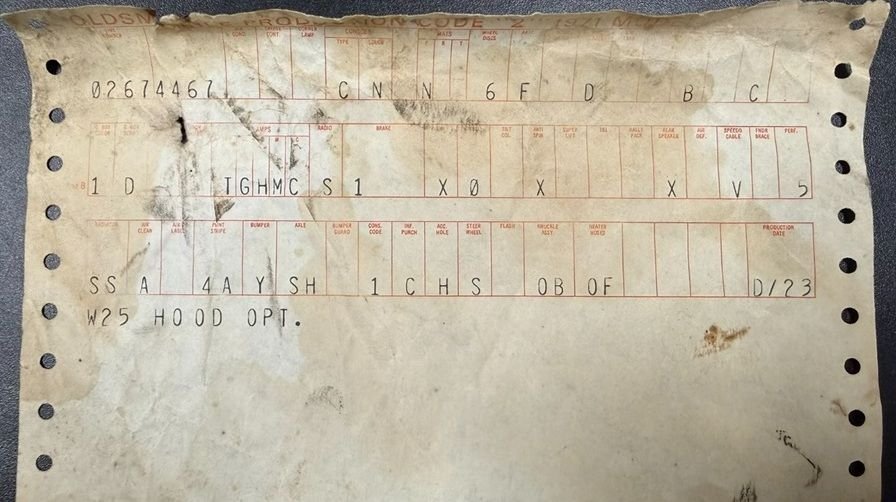

What information can this Broadcast Production Codes sheet tell me? Thanks for the help!

OAI hood and 3.42 posi. Not sure other than that but others will know.

SS coded radiator is a 3 core.

OB code knuckles are regular drum front brakes.
Looks like it has a rear speaker
