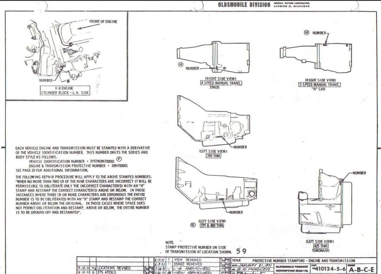

Correct, engine number does not match the VIN in 1968. I don't know about other years. You do know the engine unit number is stamped on the oil fill tube, right? Whatever fill tube is on there may or may not be the original. They are just tapped in.
I thought the engine was stamped with the VIN derivative starting in '68.
Old Apr 5, 2024 | 04:37 AM
The engine unit number for a 1968 car is stamped on the oil fill tube. Prior to 1968 it was stamped on the front of the passenger side head. The VIN derivative (which Olds first used starting with the 1968 model year) will be stamped on the block below the number 1 spark plug.
VIN derivative is different from engine unit number. Yes, the VIN derivative is stamped on the block beginning in '68.
