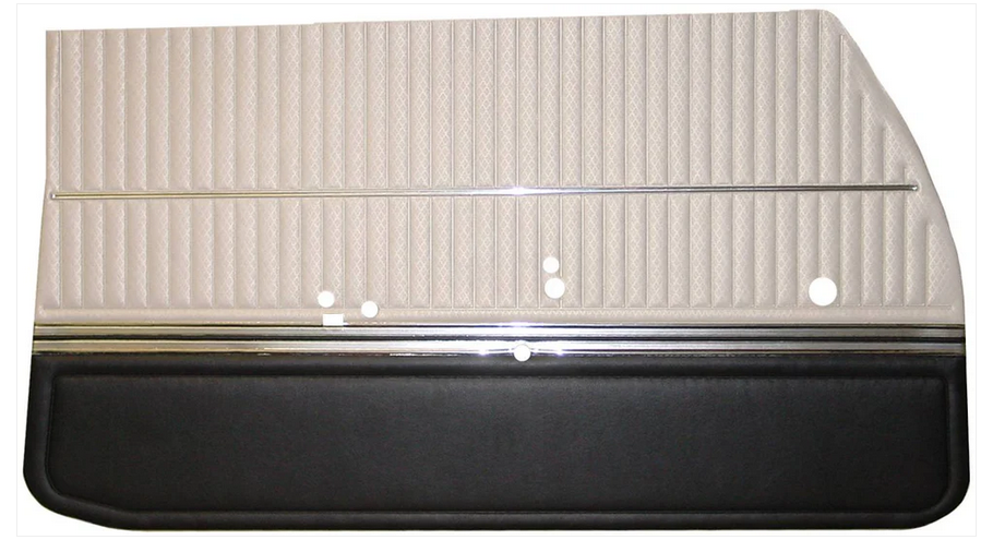

I’m looking for door panels for my 68 olds 442 vert. Who makes the best available? Do they have carpet on the bottom? Parchment. Thanks

I would go with Legendary. Convertible and Holiday coupe door panels are the same. Sports coupe is not. 68s did not use carpet on the door panels. Edit: I just noticed that this photo doesn't have the hole for the vent window crank.

Sometimes Legendary will put a pre-punched "scribe" circle on the door panel panel board (backside) for "optional" items that may (or may not) get used on the car. Remote mirror "cutout" is like this....no hole all the way through the door panel when you receive it but flip it over and you'll see where they punched in a outline of the hole in the panel board. If needed, the piece of panel board can be removed/dug out.

did 68 442 with interior code 947 have parchment / black or Metallic Parchment/ black? OPGI who reps LEG states that they are none metallic.
