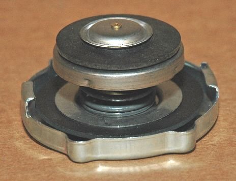

Note that the radiator cap is different when you have an overflow tank vs. when you do not. The correct cap with an overflow tank (closed system) contains a seal that allows coolant to be sucked back into the radiator as it cools. The earlier caps without overflow tank (open system) do not. The difference is that the cap for an open system has only one seal on the small part of the cap that fits inside the radiator neck. The cap for a closed system has a second seal that fits against the large diameter part of the radiator neck also, allowing the suction to draw coolant back in without leaking. You can use a closed cap on an open system but not the other way around. Most caps today are closed type and shown as applicable for both systems. Note the two seals on this cap. An open system cap would only have the smaller seal.
