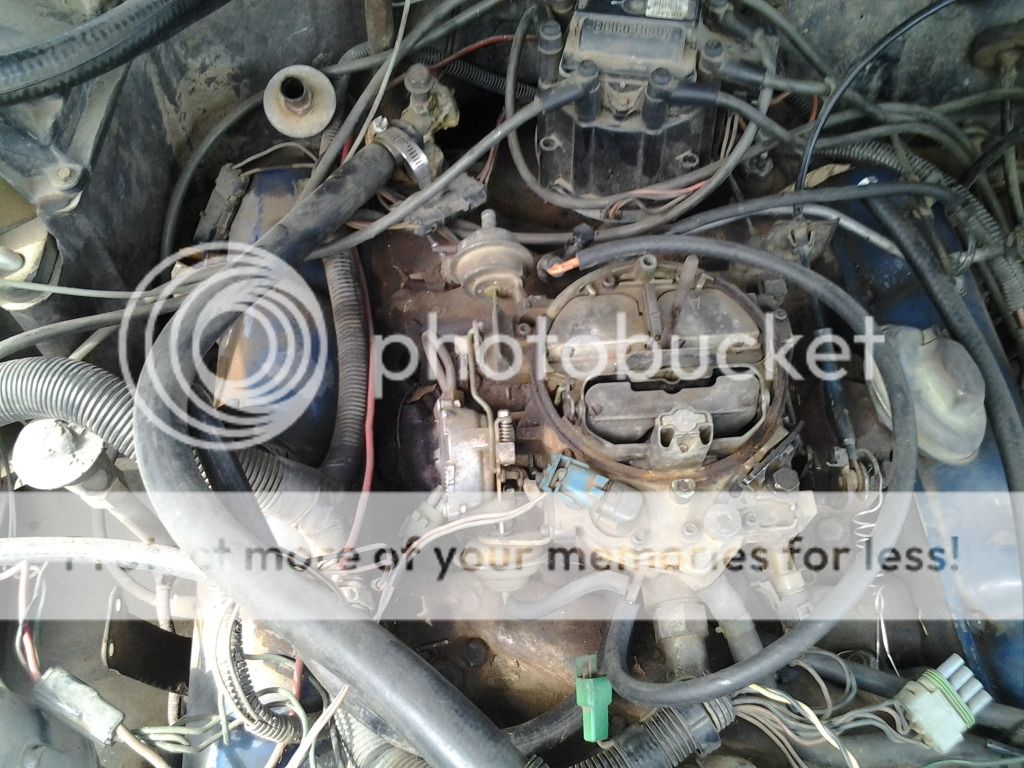

No, it has an electronic advance due to it being computer controlled. GM never made an HEI that was purely mechanical. They either used a vacuum advance or they were computer controlled.
Vacuum:
Computer controlled (this also shows the computer controlled carb)

There is no computer I'm thinking this is something the past owner decided to do in a get most answers tomorrow I'll let y'all know I'm going elbows deep tomorrow I'm thinking past owner just threw **** together in till it cranked lol it's a mess hoses out of place running weird ways a lot I'm not using I am to moving a lot tomorrow

Trust me when I was that all we are doing is trying to help you. If you can get some good pictures of what you actually have, that would help us greatly in trying to diagnose your issue.

Look, we're all guessing right now. If the OP can post a photo or two, it will allow us to provide much more useful info. The 4.3 diesel V6 was factory available in 1984. If this is a diesel car converted to a gas 307, we have no idea what carb and distributor were used until we see photos.
That is an excellent point Mr. Joe. Does it say DIESEL on the fuel gauge?
