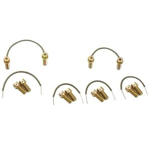

These are the fasteners I use,available at autozone for $10.

Thanks again, those are some interesting looking bolts, how does that work? I have seen studs with hold in them for cotter pins to keep the nuts on but nothing like the ones in the pic. should get the headers tomorrow and will give the install a try. will post results when done.
Old May 31, 2012 | 01:51 AM
Nasty455's Avatar
XCELERATIONRULES!
Joined: Mar 2012
Posts: 323
From: Orwell,Ohio
Some times the bolts are hidden behind the header tubes.
Slipping on the locking pins would be a real headache.
I worked on planes for a short while,and every nut is safety wired,so they cannot loosen...same concept here.
The wire keeps the nut from backing off.
Still a challenge to fish the wire through the eye in the nut,but not impossible.
