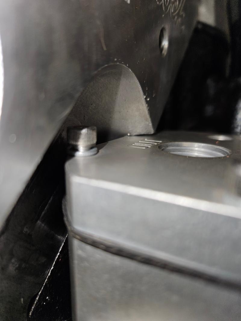

Mine didn't fit without doing some clearancing on both the pump and the head. Hopefully they've used the time since the BBO heads were released to incorporate some lessons learned into the SBO design!

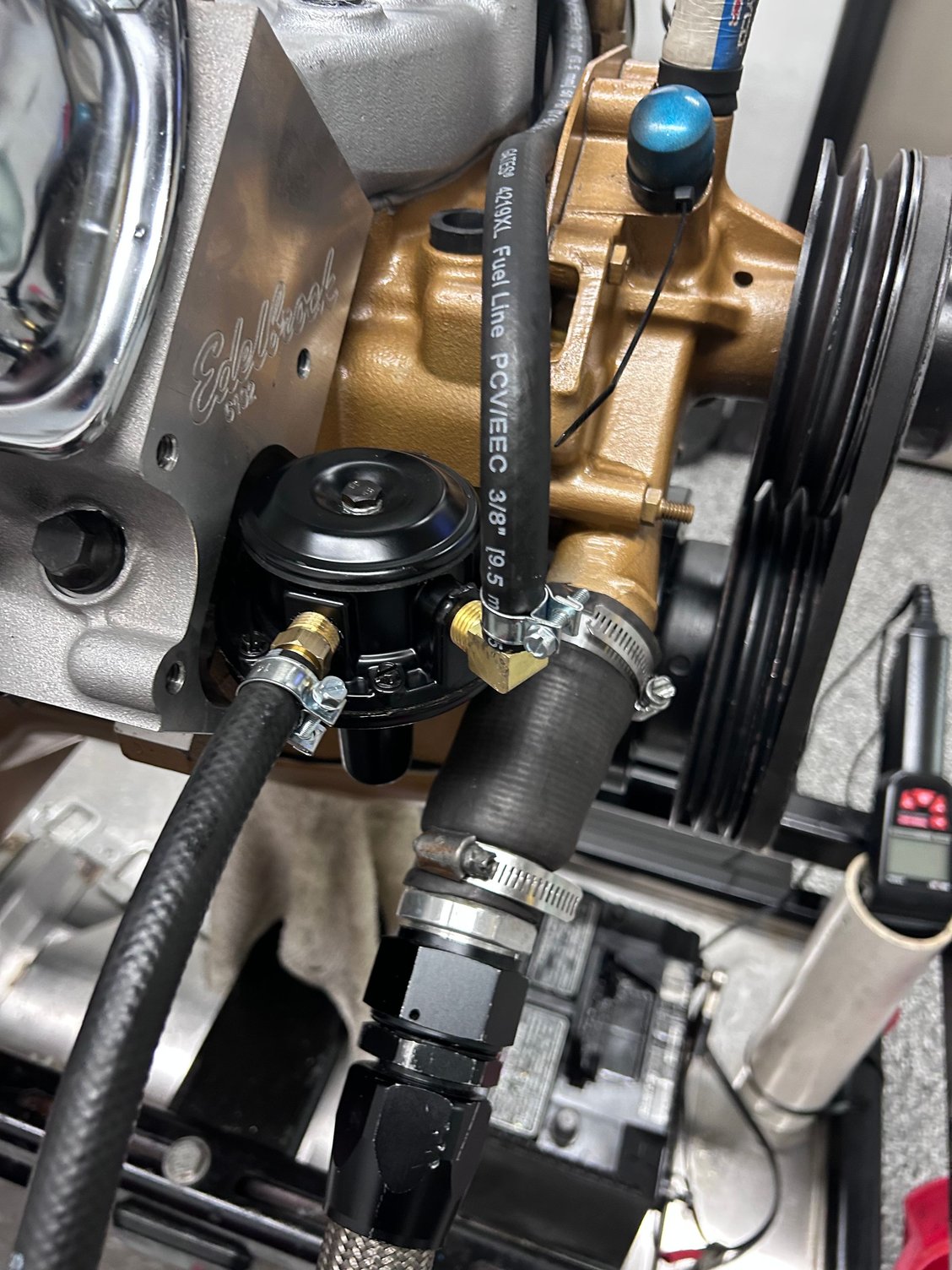

Most pumps will fit, even on a small block. This is a 403 with a TSP pump.

I was replying specifically to the RobbMC pump combo. Insufficient clearance in the recess.

I gotcha but I would venture to say most wouldn’t need to run those. The TSP had no problem supplying enough fuel for 450+hp.
