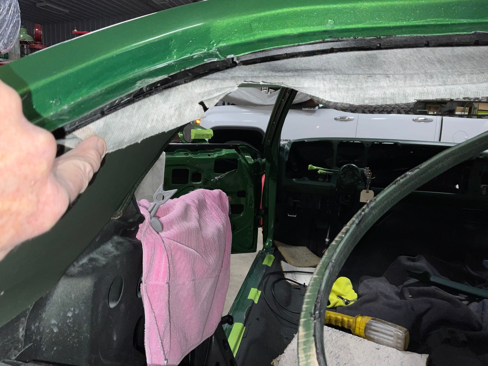

Need a little help here. The installed windlace is above the surface where the back glass will sit. Seems to me that you would want both surfaces to be the same to eliminate excess sealer that would lead to the stainless to sit too high. Should I trim it level?

No - you shouldn't have to trim the windlace.
Can you post a good pic(s) showing the windlace removed and focus on the metal piece(s) that you have the windlace attached to?

Also.....almost looks like someone already partially trimmed your windlace....or at least the D side as it runs down towards the base of the rear glass. I'll check some originals I have here.

It does look like someone trimmed it. Maybe the metal trim needs adjusted down.

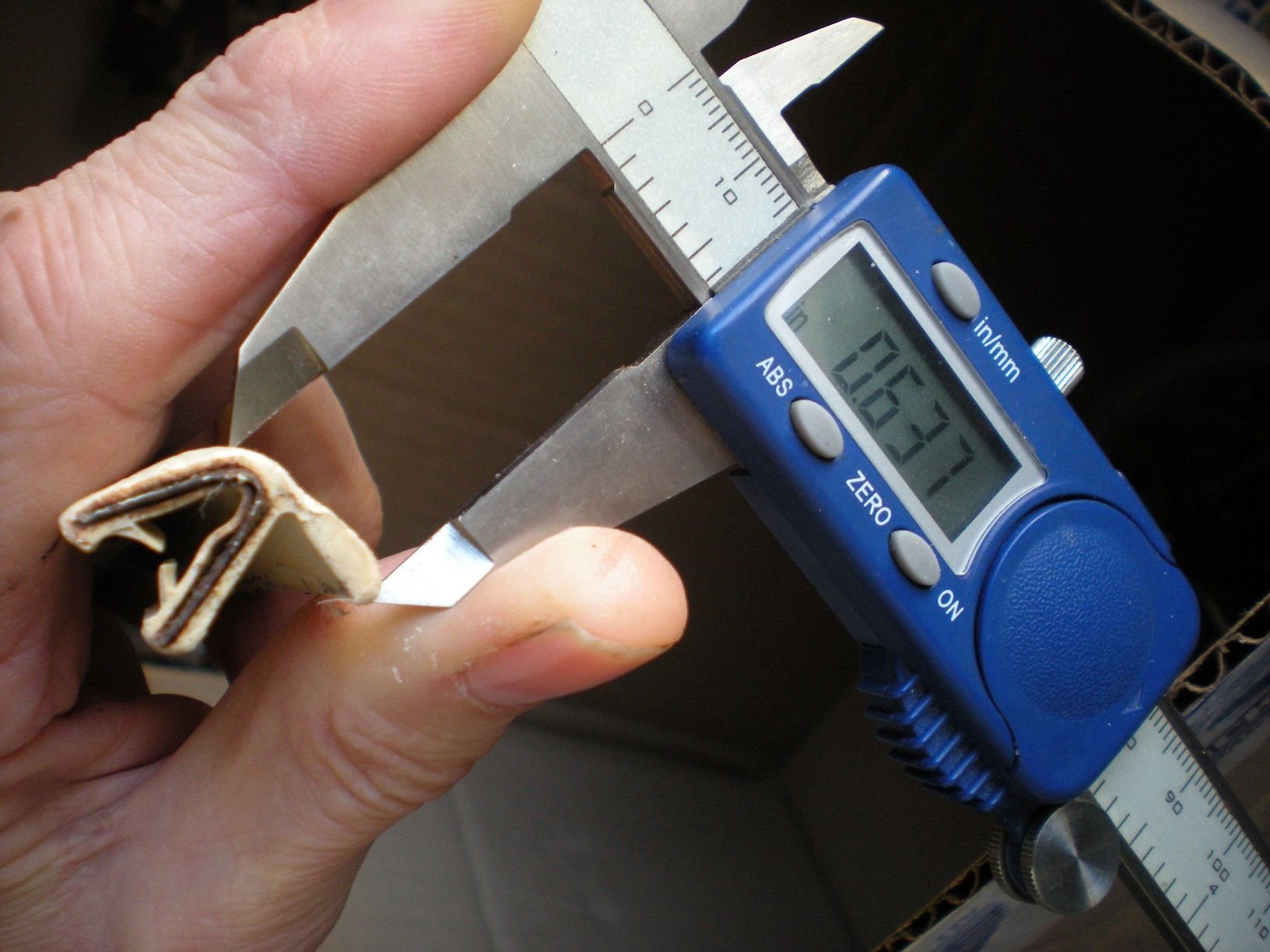

FWIW - pic shows a "rough" dial caliper measurement of the part of the windlace that sticks up towards the inside of the rear glass when installed. At least gives you something to "compare" to. The windlace is original to a '70 Cutlass/442, etc.

The excess length above the pinchweld is to account for the thickness of the sealer (urethane or butyl). The sealer needs to be about 3/16" - 1/4" thick. If the sealer is too thin, there will be a gap between the glass and the stainless.

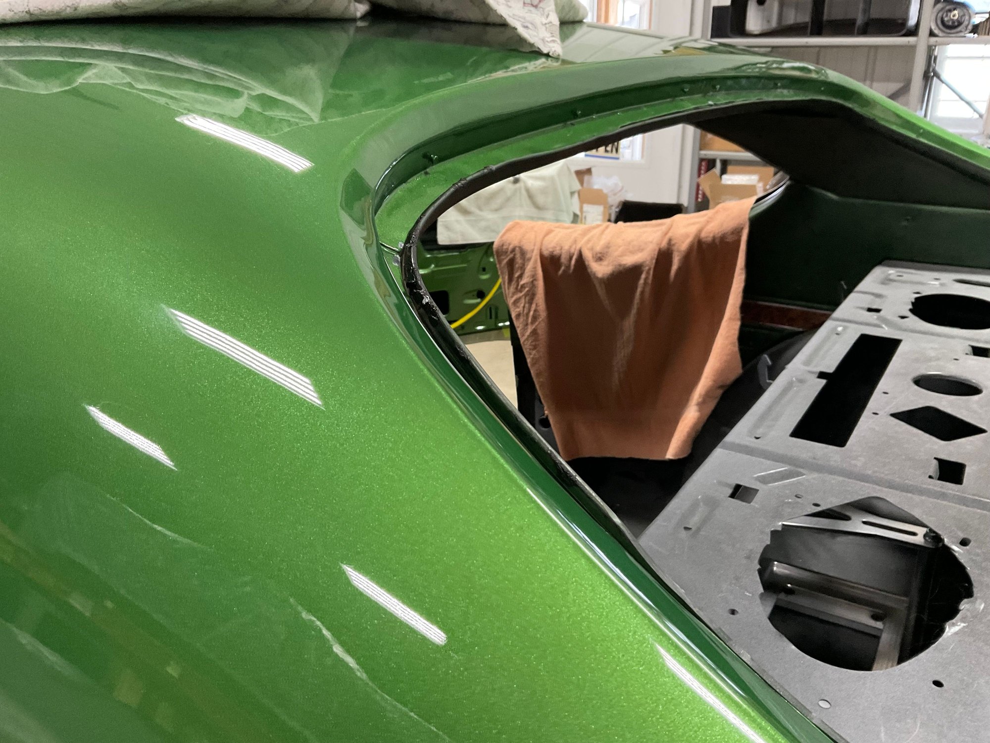

Here is a picture under the headliner without getting crazy. All the metal track is in place and nothing looks out of wack.
The struggle is real…
