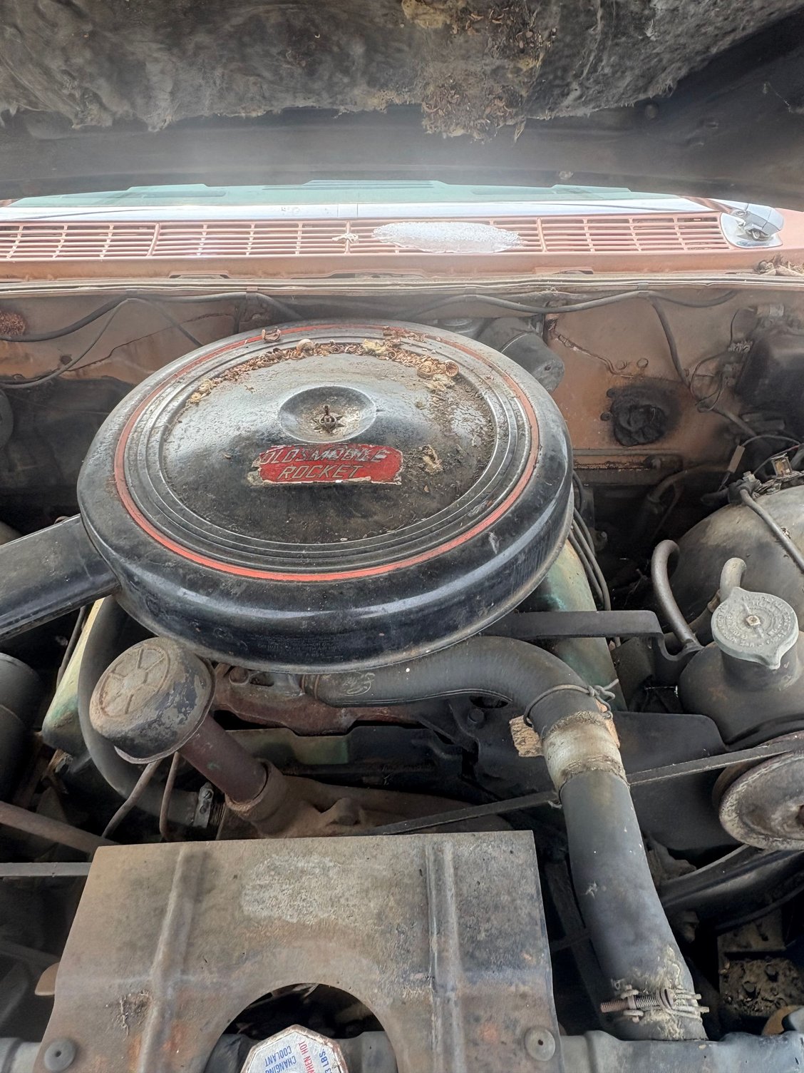

So I'm looking at a 1959 98, current owner says "it's a positive ground" , I raised hood and looks like that's way he has hooked it up. Battery un hooked but look like he did have it hooked up like that..
My question what damage has been done, how bad is he did that , says it was running before ?

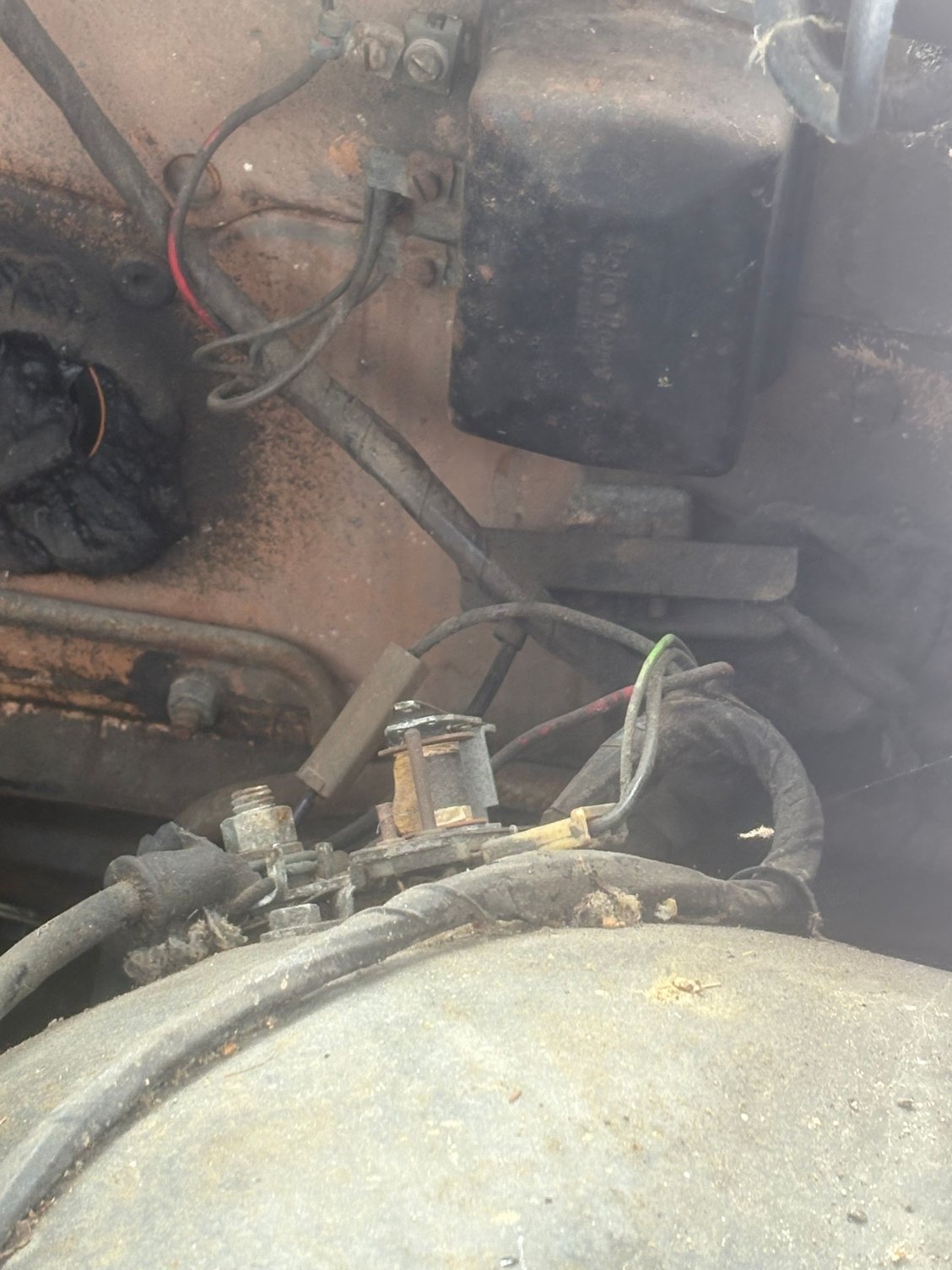

So I knew the previous owner before he passed away.. The car only has 10,000 miles since 1983. It sat in a garage. I looked at it probably 15 years ago. The son has it now. And it's up for sale. I'm supposed to meet him on the 21st and he continually says it's a positive ground car although everything I've read and everything from Oldsmobile says otherwise I have documented oil changes from 1982. It was on the road and registered till 2000
I'm not sure I can convince him it's not positive ground. I guess I will let him start the car that way. It's his car so I guess he can do what he wants
But nothing has been rigged or changed except for new paint done to the car. I'm not sure what year that was done

Looks like an OE Delco voltage regulator. Ask him to get the numbers stamped on the reg mounting base. From that you can probably determine the intended polarity.

OP wants to know if damage could have occurred if the car was run on reverse polarity. The answer is probably none, but it is possible the ignition points and the regulator points may be damaged. If the regulator points are run on reverse polarity, it may have caused the points to stick in the past or possibly in the future. If the regulator cutout points stick, it could cause the generator to fry. Have you ever noticed how a set of points will have a tit on one point and a divot on the other point? There is a reason for that. Direction of current flow (polarity). Yes a condenser will minimize that but not eliminate the transfer of material from one point to the other. Running it backwards can cause bad voltage readings, premature regulator failure, or unwanted smoke when the car is shut off. The regulator in his picture has a fuse connected between the battery wire and the bat reg terminal. I would check that fuse. If it is open, then the regulator points may have already stuck. Look at the regulator stamp. If it is 12VN then connect it neg ground. Before you connect the battery, clean the regulator and ign points.
