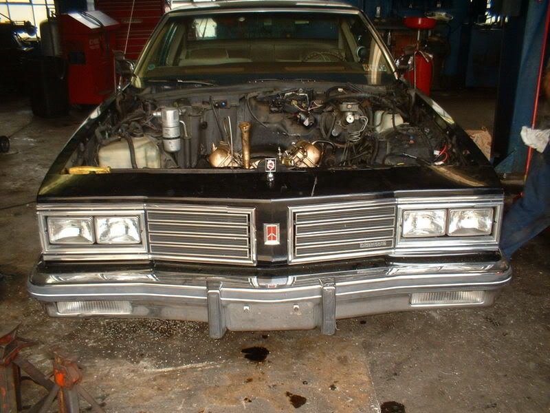

Here is the up to date of what I'm doing with my Delta 88.
Recap: I blew the motor back in Feburary, and I did a ton of searching for the prefect motor and I found one, thanks to another member on this site.
Well I did a little bit of upgrading, and cleaning, now the 307 is out of the car (called my mech a few hours ago) and on Saturday, him and I are dropping in this Olds 350 Rocket with the 350 TH tranny.
Take a look:
http://s18.photobucket.com/albums/b1...350%20project/
Take a look:

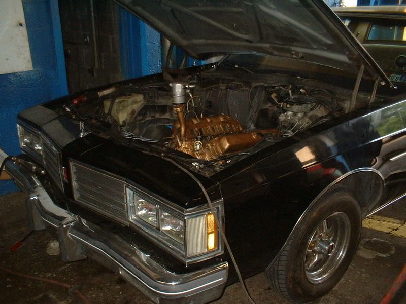

WHOO HOO!!!
Like I said in the pervious post, I had to use the old 307 exhaust manifolds on the new/old 350 I dropped in.
I just looked it up and the casting on the right side is 17-22506300, which is awesome, becuase they didn't go to the smaller ports until '86, and this casting number means that these manifolds are 81-86 and share the same internals as the 350/403 manifold except with an O2 sensor port.
The only bad thing is I sold my a/f gauge, and I don't know what I did with the O2 sensor. I don't care about the a/f gauge, I like the EGT gauges better, but I gotta plug up that hole
Updated pics and sub album created
I know in these pics, the motor looks slanted, but that was before the tranny was bolted up. BTW the tranny bolted right up, with a little bit of cutting of the bracket
[IMG]
[/IMG]
[IMG]
[/IMG]
I know in these pics, the motor looks slanted, but that was before the tranny was bolted up. BTW the tranny bolted right up, with a little bit of cutting of the bracket[IMG]
[/IMG][IMG]
[/IMG]

Carb, alt, PS pump, manifold, dis cap, starter, a/c consednsor is all in.
Heard the car crank today (waiting on a new fuel pump.
Tranny gearshfit lever hooked up
Waiting on the new driveshaft, fuel pump, etc
Hood clears the air cleaner on top
It's comming along nice
