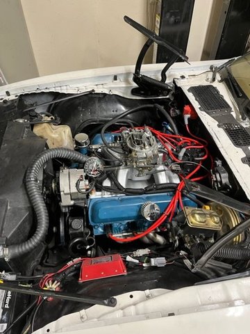

Hi all - I have a build thread going but thought I would ask it here since it seems to be a common question on Pontiac sites too but no answers. Has anyone installed an Oldsmobile 455 WITH headers, in place of the 403, etc., in a 2nd gen (70-81) Trans Am or Firebird? I have 'small block' manifolds on it now and would eventually like to re-do the entire exhaust. I understand the headaches with headers but believe its worth the HP in this case.
I have heard headers for a 455 Cutlass (74-76 body style) should work best? Does that mean all 69-76 Cutlass 455 headers will work then? I assume 403 headers would not fit due to engine being hire up than original 403? I am using the factory motor mounts on the frame and engine block if that helps.
Any input appreciated! Really appreciate a known brand recommendation (Flowtech, Headman, etc) that is known to be compatible...

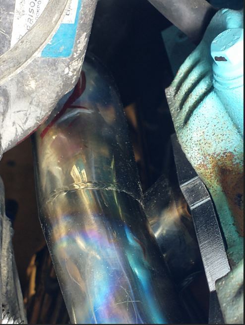

ebay stainless steel 455 / generic headers
Overdue for an update - no luck with the cheap ebay stainless steel headers unless I cut and re-reroute the last two pipes. Based on lots of googling, I may try Headman 58060 since the passenger side routes straight down instead of rearward. Overall, it probably is not possible or worth the effort or costs to run headers on the 455 in a TA. May look for W/Z/X manifolds in the end.
