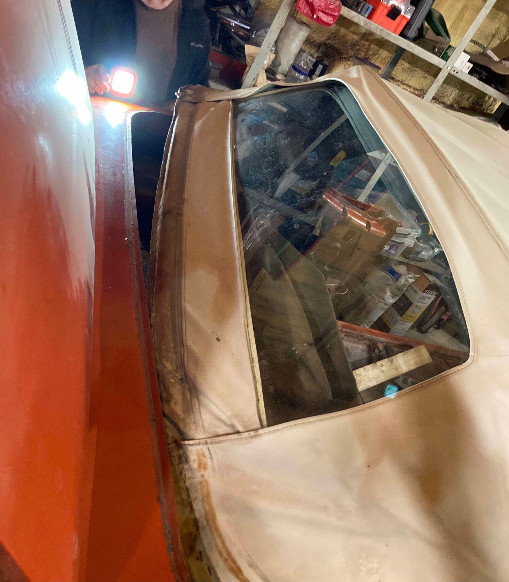

Unbolted rain gutter, and the two bolts holding rear floating tack strip bow. Drilled two 1/8” locating holes in each side bracket so they can go back in same spot, then removed the 3 body bolts in each bracket.
