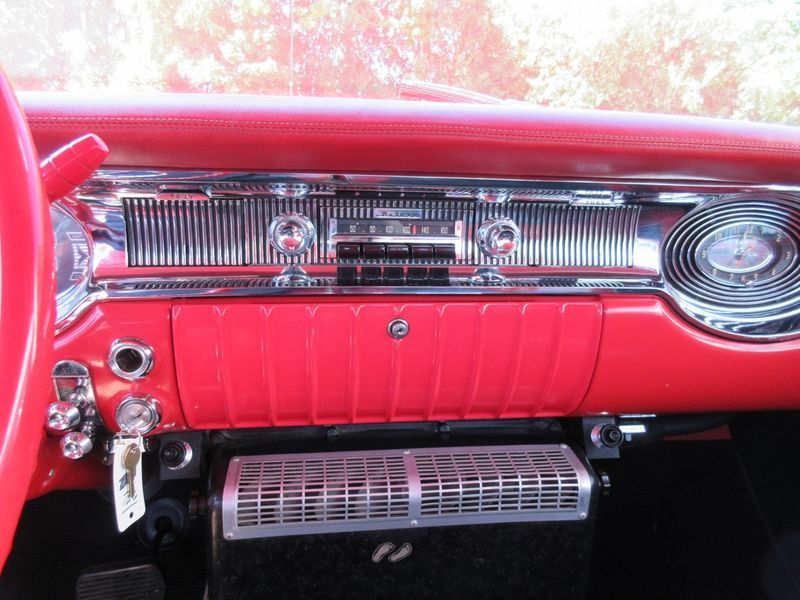

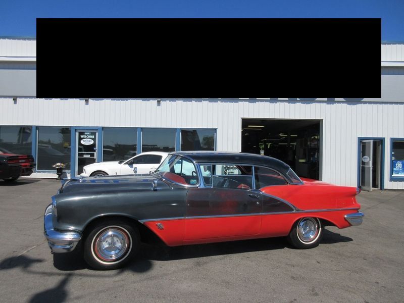

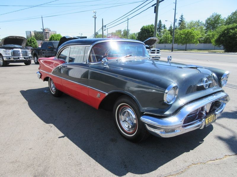

This is a photo of the '56 Oldsmobile Super 88 I'm thinking about buying. I'm guessing this is the Jetaway from the fact that it has the P letter and the shift indicator is on it?

That is one pretty dash.

...This is a photo of the '56 Oldsmobile Super 88 I'm thinking about buying. I'm guessing this is the Jetaway from the fact that it has the P letter and the shift indicator is on it?[/i]
Probably, but the only way to know for sure is to look at the gearbox. These cars are over 60 years old and there is no way to know what modifications may have been done since they left the factory without looking. As I posted earlier, I have a car with a Jetaway indicator but a slant pan installed.

I think he can make that determination pretty easy without looking at the tranmission. If neutral is with the shift lever all the way up, he has a hydra-matic. If you pull the shift lever all the way down, he has a Jetaway. All the way down on a hydra-matic is reverse.

Ok, here is another shot were you can just barely see the gear stick. It's all the way up and on Park.
As for modifications, the only things that the owner says has been added is AC and power brakes, but there always could be something else added

just by the two pics, looks like a real nice 56 good luck

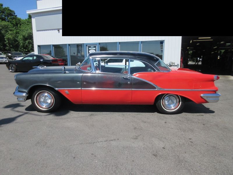

Last photo I will be uploading here, this is the side view of the Super 88. Just adding this to verify that it's the Holiday Hardtop edition (I blacked out the location for privacy reasons) Just a fun fact: I'm planning to get the exterior repainted after I buy it (Aside from the outside paint fading, it's almost like new!) The black will be Alcan White, and the red will be the 1957 exclusive Banff Blue (I like it better than the blue options for the '56)

Old March 20th, 2018, 07:24 AM
Tedd Thompson's Avatar
Join Date: Oct 2004
Location: Forest Ranch Ca.
Posts: 7,717
It's a Holiday, no post.... Tedd
