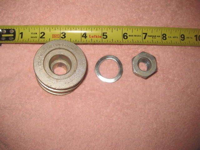

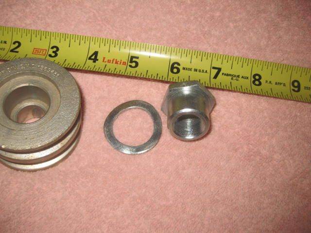

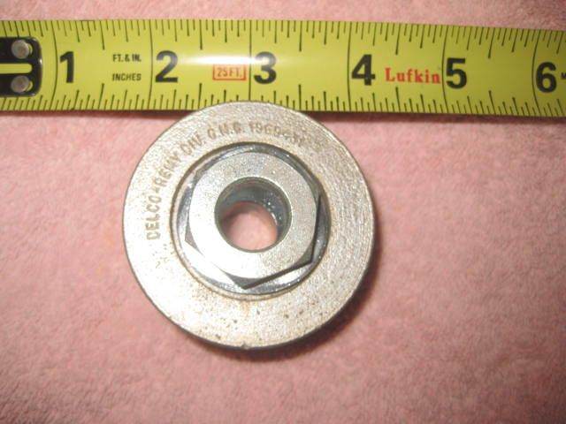

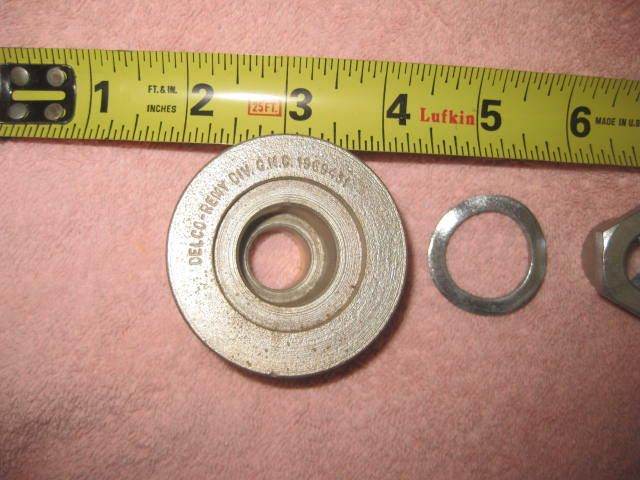

The Buick 2 groove pulley is a direct fit. OE pulley number is 1969431. It has a diameter of 2 1/4 inch. If you get one be sure the nut and lock washer come with it as they are special to this pulley. You might find one on ebay, but the nut and pulley are rare as hens teeth. If you can't find something smaller and want this one, I can sell it.

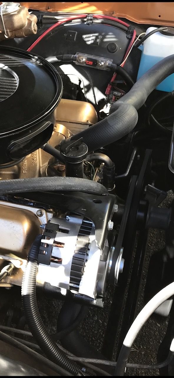

I will sell it, I will send you a PM. Looking at your link, I can't tell if it is worth changing the pulley. The link shows a serpentine pulley.What is the diameter of your pulley now? I will guess it is a single groove v belt pulley. Do you have a pic of it on the car? I am curious as to weather or not this alternator came with a conversion plug or if you bought one elsewhere. A pic of that would be nice too.
Attached is a photo.

Any luck with finding a pulley? I found another one here that is also 2 1/4 inch diameter and does not require a special nut. You may need a thin walled socket to put the nut on. What is the diameter of the pulley on there now?
