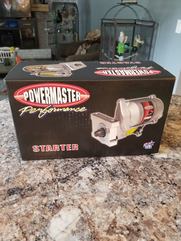

June 2023 UPDATE:
Some pics of a few parts, Hope to get it back in July but I dont no, I really would like to throw some paint on it and share some pics.
Slowest build in the world going on, over 2 years now lol
Build has gone over the 10K USA cost with no taxs, shipping, Brokerage, Convert to Canadian cost and stuff I have forgoten lol
Machinist to break down Heads, inspect, cut to 65 CC or so
rebuild them as needed, cut the intake to make fit, port match
Key Notes:
Post 87 has the cost breakdown, parts
Post 98 has the cam card
