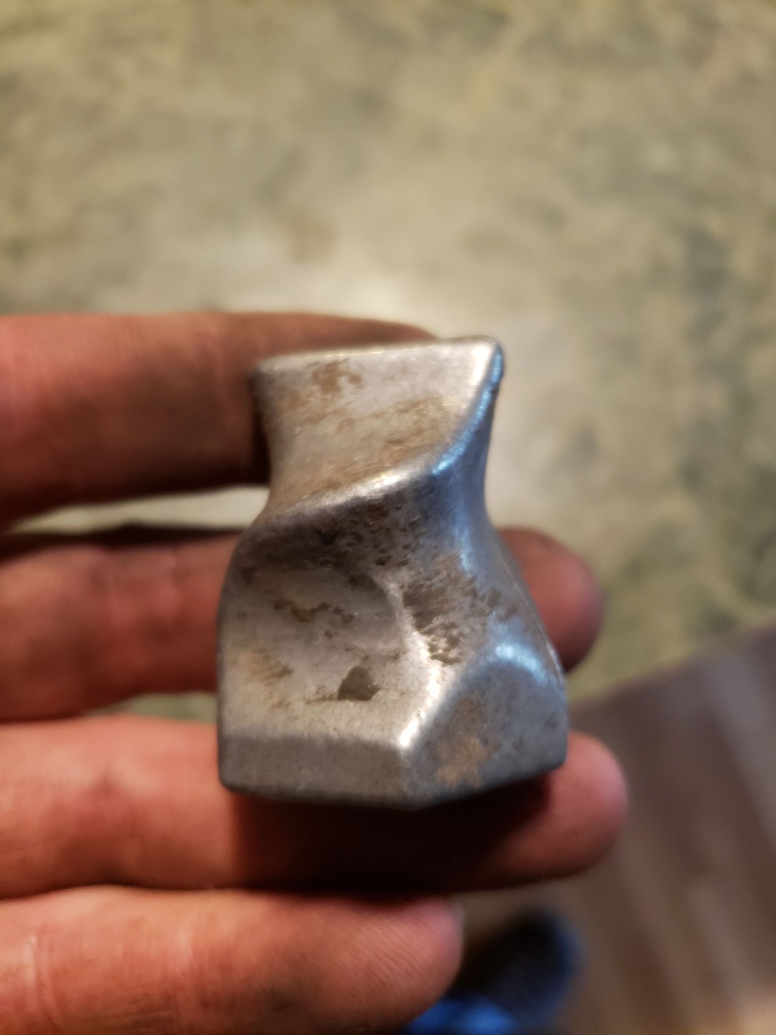

2 of these fell out of my coil spring today when I was working on the suspension. I assume they are some aftermarket adjuster? Never seen anything like them.
Bob

Exactly. Old school way of lifting the suspension some.

old coil spring helpers. used to stop sagging springs. not a good fix, but cheap and easy

I guess that means I should probably order new springs.

Amazingly, they still sell these things.

i got a pile i will sell ya.those were one of my pet peeves.any car i ever bought that had those,that was one of the first things to go.and don't get me started on air shocks!

Agreed! New springs are the way to go. I had air shocks on my Supreme back in high school and I had no idea how rough they made the ride until I installed new rear springs. Wow, what a difference - the rear of the car was the same height but it rode so much smoother with the new springs and regular shocks.
