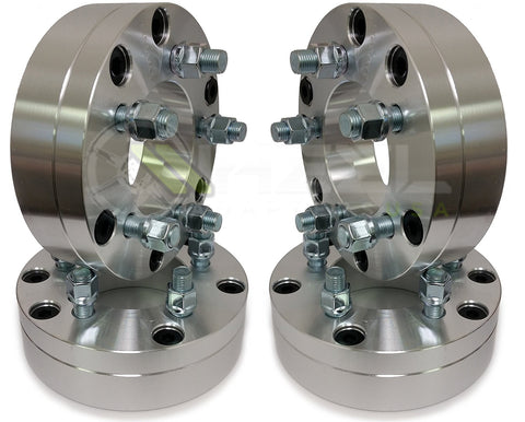

Hey Joe,
What is your opinion on wheel adapters? Vision Wheel has a nice 15" wheel. Unfortunately they don't offer a 4x4.5. They have 4x4.25 with a -19 offset 15x4 which brings it out .They also offer the 15x7 4x4.25 in a zero offset. Then of course they have them in a 5 lug. The rim in question is their 521 nitro....Sharp looking but not in the lug pattern needed.
spaceman_spiff is offline

Have you contacted the manufacturer and asked if they can drill a custom bolt circle? That would be a far better solution. The problem with wheel spacers is that they need to be thick enough to retain the wheel studs for the 4.25 bolt circle. You can make spacers like that, but they probably need to be at least an inch thick. That means an extra 25mm outboard spacing on top of the 19mm built into the wheels. You really want wheels with about 25mm POSITIVE offset to accommodate the spacers. Of course, you need to get hub-centric spacers, which most are not. I spent over $300 for well made, hub-centric spacers for my dually truck so I could run wider tires without sidewalls rubbing at the back.
joe_padavano is offline

wheel apader
Not a spacer, an adapter
4 WHEEL ADAPTERS 4X4.5 TO 5X4.75 | USE 5 LUG WHEELS ON 4 LUG CAR | 2" INCH THICK | 12x1.5
Yeah, I got it. Those are like the ones I have for my truck. It's still a spacer. It's also not hub-centric, apparently, though your desired wheels may not be either. More to the point, these are 2" thick, plus the -19mm (about 0.75") offset on the wheels, puts those wheels 2.75" further outboard. Not gonna happen on a 62, especially in the back and especially if you want decent tires on them. Again, ask the manufacturer (NOT the vendor) if you can get a custom bolt pattern drilled. I'm willing to bet you can, and not for much additional money.
Old September 2nd, 2017, 10:06 AM
Join Date: Mar 2007
Location: Northern VA
Posts: 47,259
And before someone suggests redrilling the hubs, you really can't on the front. The front hubs are not uniform in thickness - they have thicker spots where the wheel studs are pressed in. If you clock the pattern 45 degrees to drill new holes, you're in the thinner part of the hub.
Frankly, before I messed with those 2" thick spacers, er, ADAPTERS, I'd just do five lug conversion on the car. Cost will probably be about the same as for the spacers. Again, the FIRST thing I would do is ask about custom drilled wheels that have the correct pattern in the first place.
I was just using those as an example.
Again, any adapter will push the wheels outboard. The wheels you want ALREADY have 3/4" negative offset that pushes then outward, without any spacer. I have zero offset 14x5 slot mags on my 62 with no spacers/adapters and 205/70-14 tires and they have less than 1" of clearance to the wheel opening lip on the back. Do the math - or, buy the expensive wheels and tires, have them mounted, see for yourself they won't clear, and then find out that you can't return them once tires have been mounted. Your call.
