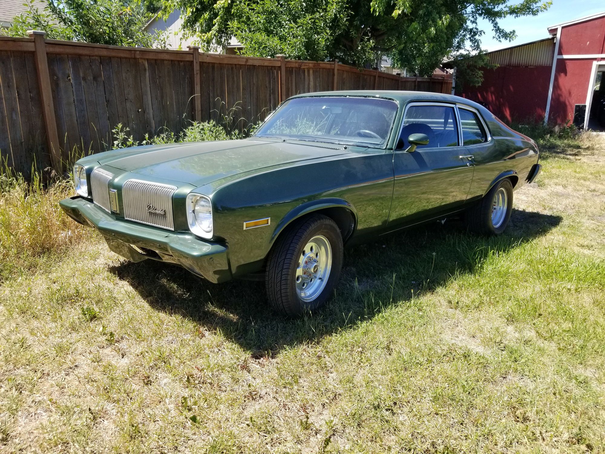

I am still here, sorry about not really concluding this thread. I am a very busy person at the moment. The car is 99% complete at this point. I have all new interior, including a headliner from acme auto headlining. I have driven the car to work several times. needs the windshield chrome installed, and an exhaust built, and the subframe connectors installed and other little work, but she is pretty close. My summers are pretty busy, this is the time of year i have more free time to play with cars.
