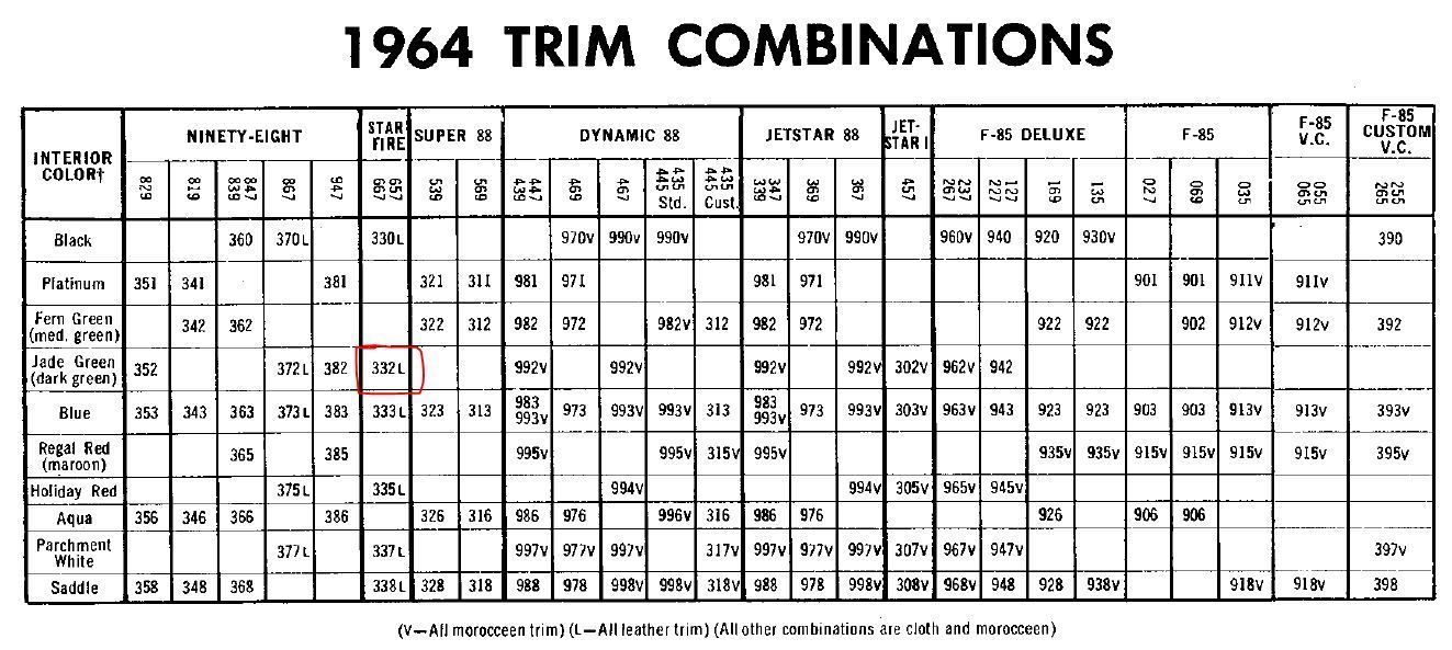

3. According to this chart, Starfire interiors used a vinyl / leather mix. My cowl tag only says 332, not 332L. And maybe I don't know leather bolsters when I see them, but these seats sure seem all Vinyl to me. Was all Vinyl an option? I'm sure the seats haven't been redone.
MichiDan is offline

Leather usage on seat facings and bolsters: 61 all leather, 62 all leather, 63 leather facings/ vinyl bolsters, 64 reverse of 63, 65 same as 63, 66 all vinyl. Side skirts and backrest cover were vinyl all years.
332L was a sales and ordering code and doesn't show up on cowl tag. It would have had leather originally, but after 53 years?? My Fern Mist still has its parchment leather, but the Bermuda Blue had it replaced with vinyl years ago because I didn't want to spend the money for a custom dyed metallic blue leather hide.
