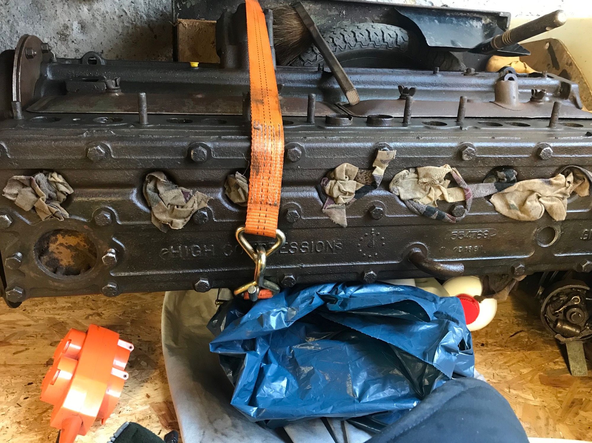

Hello, my name is Michael and I have been screwing around with US classics for many years. Currently I am restoring a 1935 F35 Coupe with 3 windows and suicide doors. I'm thinking about replacing the original engine with a 257 in-line eight cylinder, does anyone know more about the High Compression lettering on the cylinder head? Greetings Michael
The F-35 has a six cylinder engine . Putting an in line eight cylinder engine would be next to impossible . The eight cylinder cars ( L-35 ) were slightly longer . 121 " wheelbase , compared to the F-35's 115 ".
The difference in length was in the distance from the cowl to the front crossmember where the radiator is and where the engine front mount is .
The frames . hoods , hood side panels , and front fenders are all different .
A better choice would be a 257 cu. in six cylinder engine from a '49 or '50 Oldsmobile "76" .
According to the numbers on the head , this engine came from a 1948 Oldsmobile "98" .
After WWII , "premium" fuels were coming in to vogue . Oldsmobile took advantage of that by offering a " high compression "
cylinder head in some models . This head gave greater power AND economy , over the "standard " head when used with premium .
BTW , the head was cast just after midnight on April 16th , 1948 .

Thank you very much for your greetings and helpful information. The original engine from 1935 is still in the car. The row eight from 1948 is in my garage.
