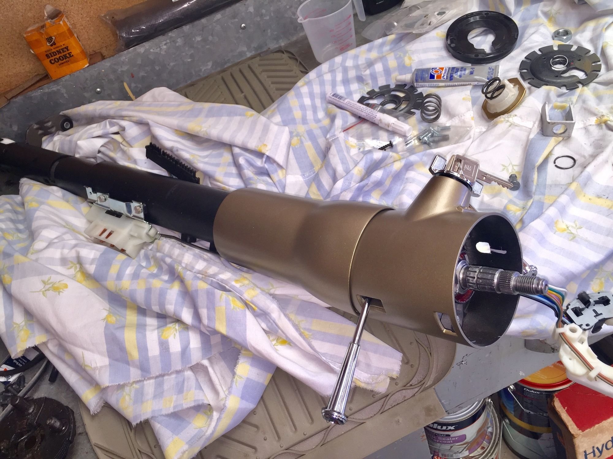

Feb '19 Update
Well unfortunately with spring now well past we are in the middle of summer here in Australia so its over 100 degrees and a bit too hot to be crawling under the dash today but my slow project continues. Here are a few recent picture updates of the windshield in, booster & master cylinder on and the rear bumper on with the assistance of my brother and son. The seats are also back together with the original trim and have come up really nice Next weekend I'm hoping to get the dash in and it will soon be time to get the front panels back on.

Well over the last few weekends I installed the wiring harnesses onto the dash, repaired the damaged ends of the drivers side A/C duct & got the dash back into the car. The dash was in and out a few times after finding the car originally had a rear defogger and the switches and harness for that had to be fitted. Timing was perfect when Scott Winn listed a complete defogger on FB. I've bought one of the reproduction AM/FM radios by Antique Auto Radio and it certainly looks nice. The original instruments were restored by Scott Winn and they look awesome. This week it's time to strip out the doors and go over all the mechanisms. I've been thinking for some time about changing to a quick ratio steering box and after chatting to Hector Carrillo I've ordered one from him so I'll fit that once it arrives and can then get the column back in. It's all slowly coming together and should be all finished by the end of Fall over here in a few months time.

Old February 25th, 2019, 04:16 AM
  #58
scrappie's Avatar
Join Date: Mar 2007
Location: eastern MA
Posts: 1,385
Did you use the chrome marker pen for dash trim or something else?
scrappie is offline
Old February 25th, 2019, 09:34 AM
  #59
Join Date: Feb 2009
Posts: 1,983
Exclamation
Spaz Stix Mirror Chrome is a two part chrome paint that you apply with an airbrush.
There is a black undercoat and a chrome top coat.
WAY better than the paint markers.
Having the dash out is a masking and spraying job.
My442 is offline

Old February 26th, 2019, 03:09 PM
  #61
35olds's Avatar
Join Date: Apr 2014
Posts: 181
The original on my dash wasnít really that chrome looking so the silver paint pen from ILT was a very close match.
35olds is offline
Old February 27th, 2019, 04:21 AM
  #62
Join Date: Feb 2009
Posts: 1,983
The trim on your dash was not chrome looking, as it is 45 year old faded vacuum metallizing.
That is why the paint pens match.
My442 is offline
That could well be the case but normally vacuum metallizing extends beyond the exposed zone. I used thinner to clean the surrounding surface in a few places but nothing showed up. My crash pad isn't the best and the dash will come back out when I can find a better one so I'll certainly keep this in mind and when it comes out again it might be an opportunity to redo it. Thanks for the feedback.
35olds is offline
