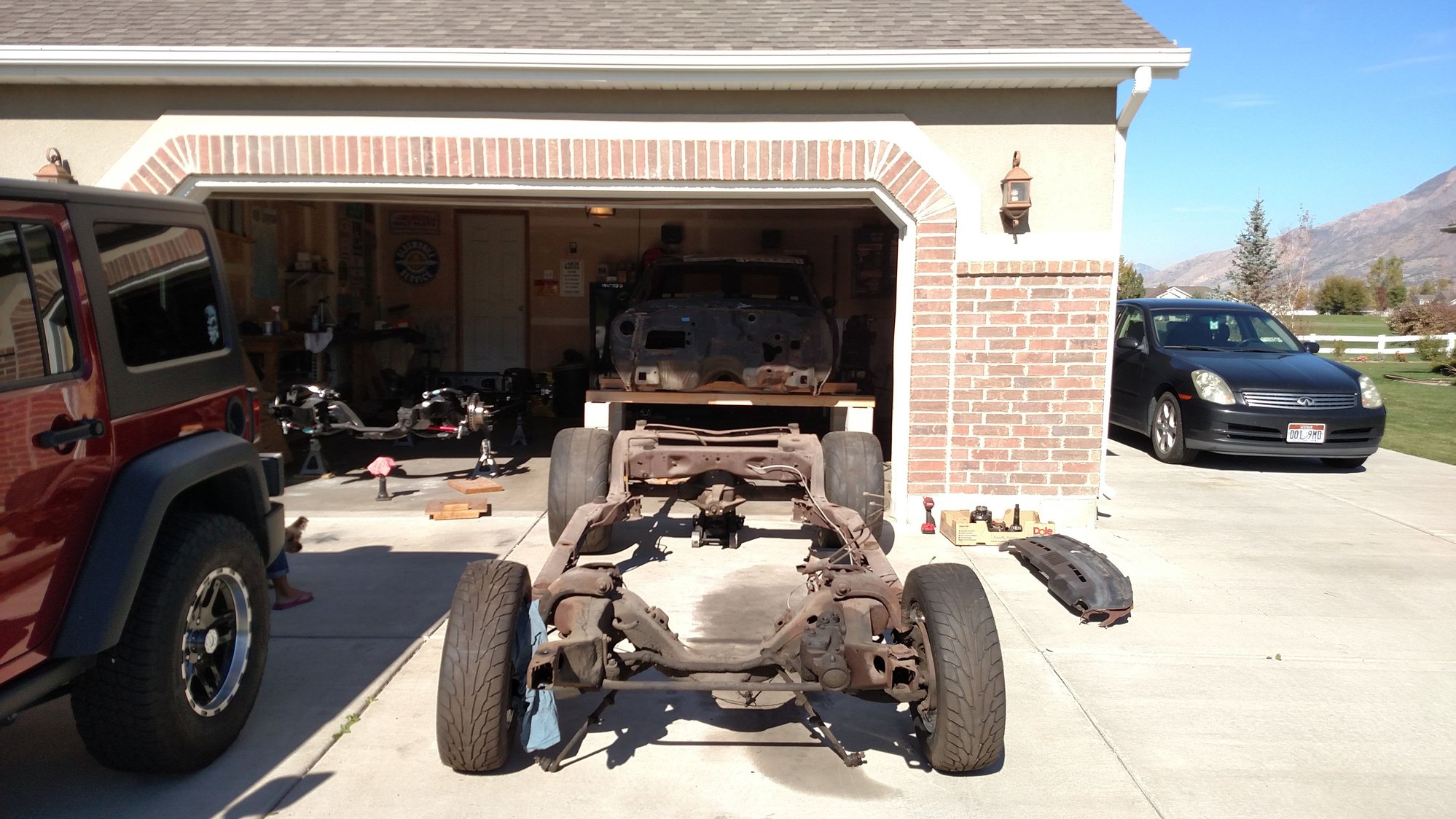

Well, a little over a year ago I picked up a cloned 1970 442. For the last year it has just occupied a bay in my garage since I've had no time to do anything with it. Although I still have no time I decided to get after it with the goal of getting the car solidly in the low 10's. I will update this thread as progress continues.
Day one
The project begins

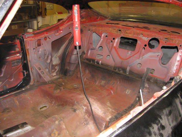

Interior stripped out

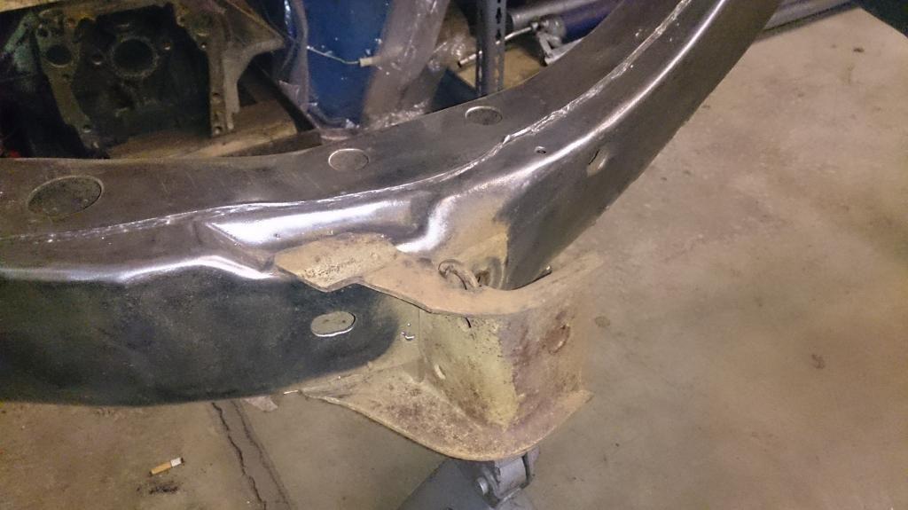

And this brings us up to date..
The original frame was rotted from the rear axle back; luckily Alek72us hooked me up with a frame in good condition. A couple weeks ago I kicked my wife out of the garage to move the frame in and start boxing it up.
Goodbye, weak *** control arm mounts..
The beginnings of a Hellwig “Frame FX” kit…

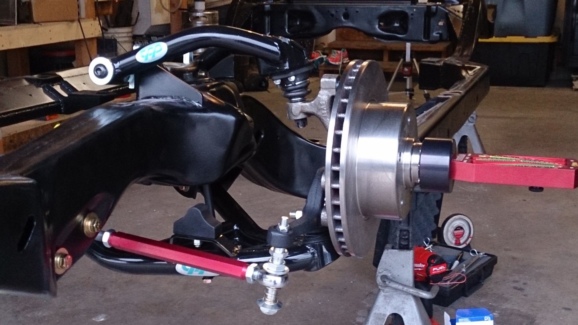

I got the upper sections of the frame rail fitted and everything tacked in ready for final welding..
More parts showed up as well, this completes the front suspension and steering..

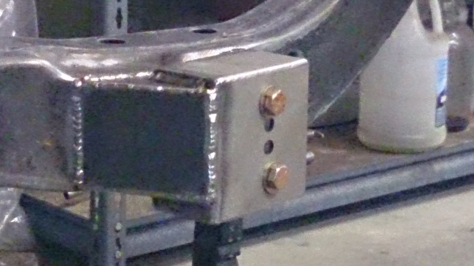

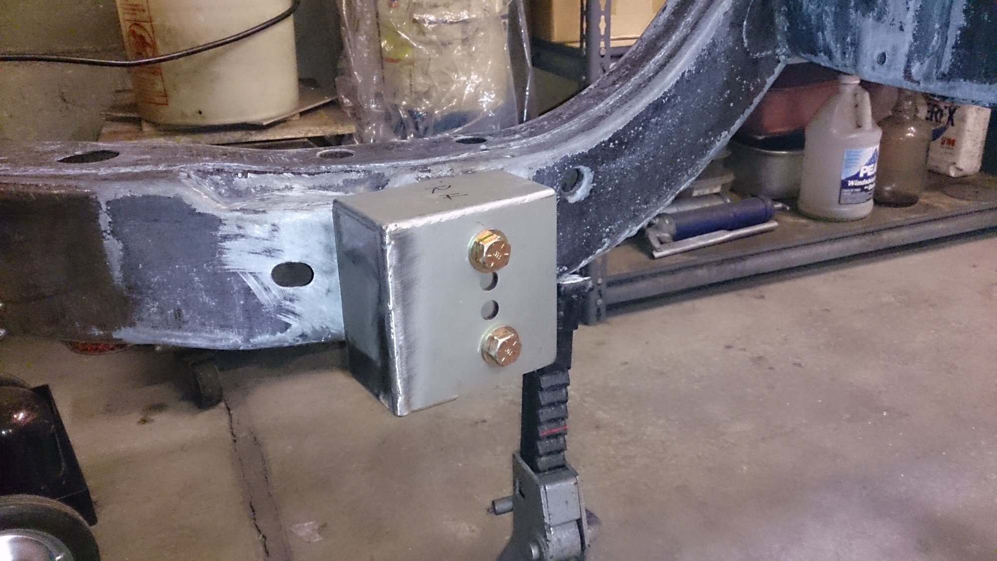

Adjustable lower control arm mounts are located and ready to weld...

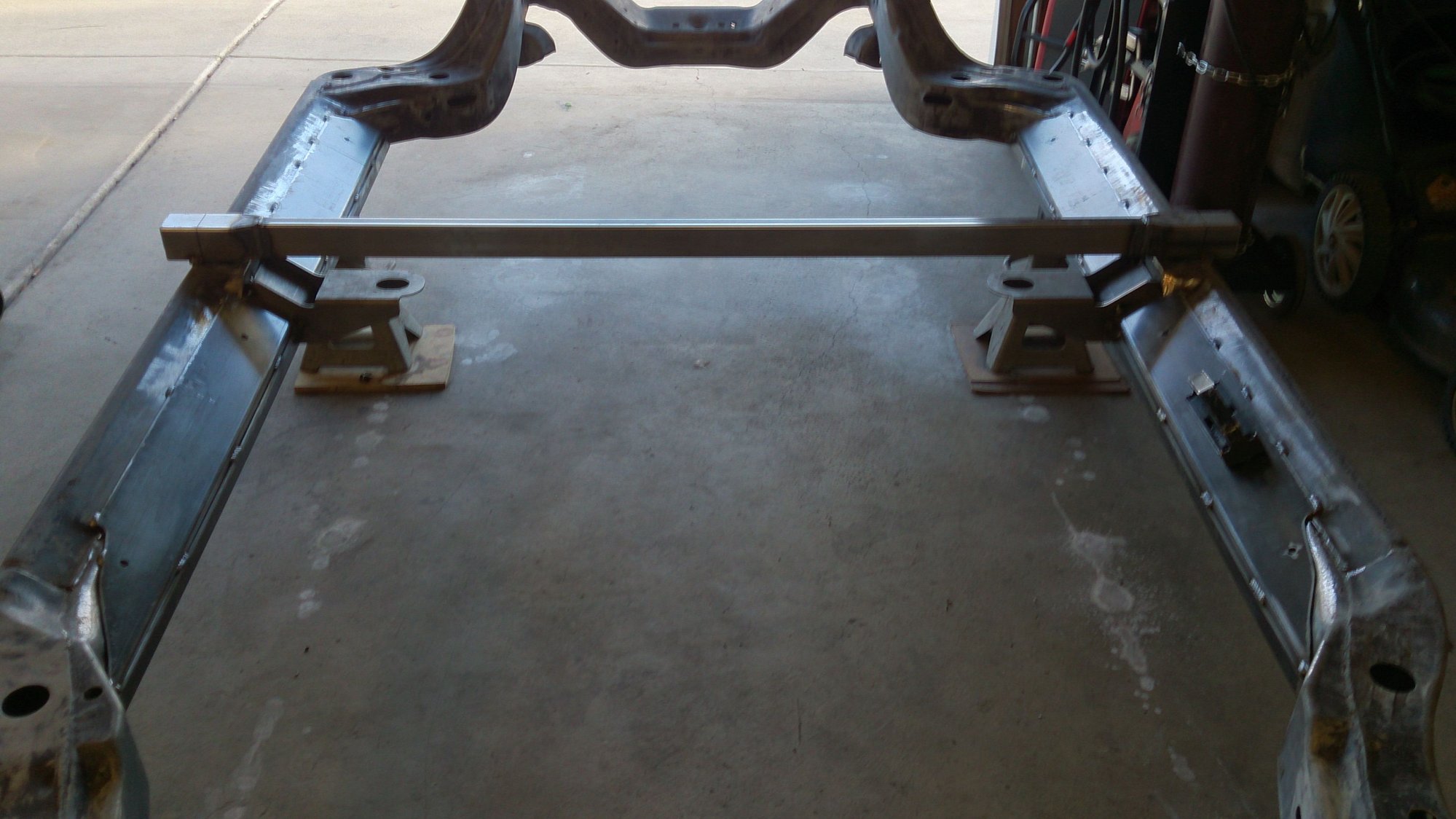

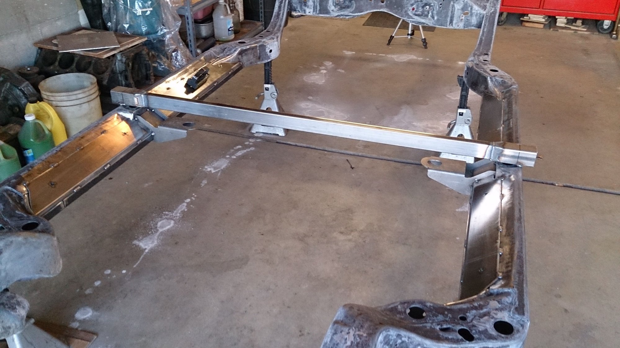

I haven't gotten much done on my junk but, aside from fabbing up some gussets for the rear upper control arms and a transmission crossmember the chassis is about done.
Rear Lower control arm mounts and frame welded in.
Rear Anti-roll bar welded in.
Now I need to figure out a mounting solution for the Fuel cell and battery box.

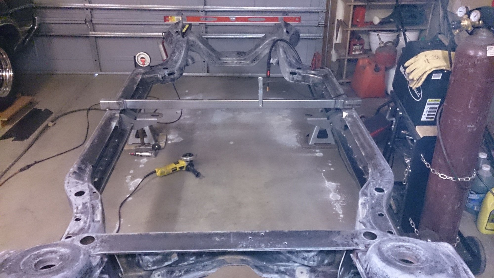

Front suspension is mocked up and measured out.
Right now I am shooting for a front crossmember height of 4.5", that seems to be where the a-arms are happiest. These arms required 0.300" of shims to zero out camber and have 0.5*caster built in...I was hoping for a bit more caster but, you get what you pay for. I will also end up with a scrub radius of 3" which will be very managable with manual steering.
I have all the measurements taken down to map everything out for the front end(short of bump steer) and will probably post all that up since there really isnt any real info on aftermarket a-arms.
