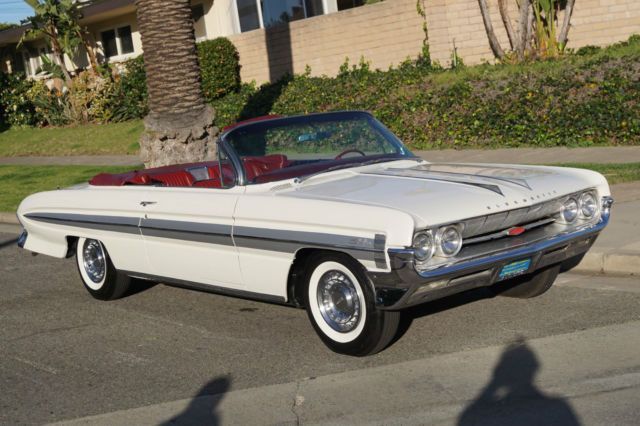

New guy here, am I in the right spot for these questions? Took delivery of a 61 starfire 2 days ago VIN 616C01375 and have lots of questions I'm hoping to get help with. Owned a project when I was 17 but never hit the road with it. Glad to have one again.
I've read there were 1500 produced in 1961 and also read there were 7800.
My engine is stamped G169207S. Understand the G is 4 barrel and S is starfire but would like to decode the numbers.
intake is stamped 580677.....1962?
The set of original wheels and 4 ply bias tires came with the car. Would like to get a new set of radials that match those from the factory. Does anyone have the specs and size of the white wall? How can I determine if the wheels are correct before I have them powder coated? Gloss or semi black?
Good source for parts? Looking for rear speaker grill and emblem, more so the emblem.
Thanks for reading and hopefully answering.

Quote:
I think the 7800 number is closer to reality
The numbers are simply a sequential serial number.
Sounds right for a 1961 manifold.
Wheels should be 14 inch with 5 bolts on 5 inch pattern , gloss black .
Whitewall tires of any kind are going to be hard to find in 14 inch , maybe Coker tire etc.
E-Bay is probably the best place to look . I've seen one there recently , maybe still there .

Thank you Charlie. Spent some time with the car again today so a few more questions.
Ordering the wheel cover clips from Fusicik tomorrow. Understand that 61 clips were special. Any issues with these clips? I know aftermarket parts don't always work as advertised.
Were all the wheel covers painted at the inner ring ridged area and if they were, body color or interior color?
Still working on decoding part of the ID pad at the firewall. Body BC 380, Paint CL and ACC is blank next to it. Wondering what accessories would have been noted here.
I noticed that the shifter doesn't show an indicator in the window. Assuming there was one, just missing.
Was the underside of the hood painted all body color? I've seen some all black and others with black braces and body color at the front of the hood.
Appreciate the help!
Mike

Posts: 1,525
Fusick sells top notch stuff . And if you do have problems they will work to sort them out .
Not sure about 61 wheelcovers , maybe others will chime in on this.
Body BC 380 = 380th Starfire body built at South Gate , Calif.
Paint CL = Provincial white with Garnet mist accent stripe
ACC codes were typically for options that would have involved modification of the body . Such as air conditioning or rear antenna .
Yes , there should be a red shift indicator .
Not too sure on the hood color either , I would think all black on underside but I could be wrong . Others may know for sure.
BTW ; I'd like to invite you to join the "darksiders" on this thread;
https://classicoldsmobile.com/forums...ers-unite.html

Purchased two weeks ago off of Ebay. Going through the car figuring out what I have and what parts I need. Have been able to trace the car back to Ohio (title May 2011, owner unknown) Pensylvania (titled July 2014, owner unknown) then it was bought at a mecum auction around january in Florida and sent to Utah. That guy sold it and a dealer in Santa Monica sold it to a guy in Missoula Montana 6 months ago. Cars been doing a lot of flipping. Would like to trace back further but think it will be really difficult to do so. Know it was built at Southgate CA though. Appreciate any help bringing this baby back to original and fully functional. Spent the day yesterday tracing down electrical shorts and figuring out what parts I need. Anyone have a door switch or rear speaker grill/emblem? Good source for engine related parts like a OEM valve cover breather or the premolded rubber hose that connects to the PCV valve?

Good Gawd, that's beautiful! Love it. Nice car sir!

Welcome. Very pretty car, doesn't look like it needs much. Love to see more pics. You may want to start a project thread.

Nice car, the 61 had a down draft pipe on the passenger side of the engine, if your car has a breather on the drivers side and a PCV valve that runs to the rear of the carb then this car was originally a Ca. car. I don't know if this car would have to be updated to this system if it was sold in a different state and then returned to Ca.
I would check with Fusick Automotive on the east coast for some of the switches, scripts and rubber components. The side panels are being reproduced now but the aluminium panel across the rear is not. Evil-Bay is a good source for other parts and definitely the national meets.
Good luck with your quest to find the parts needed to bring this beauty up just a little better.
