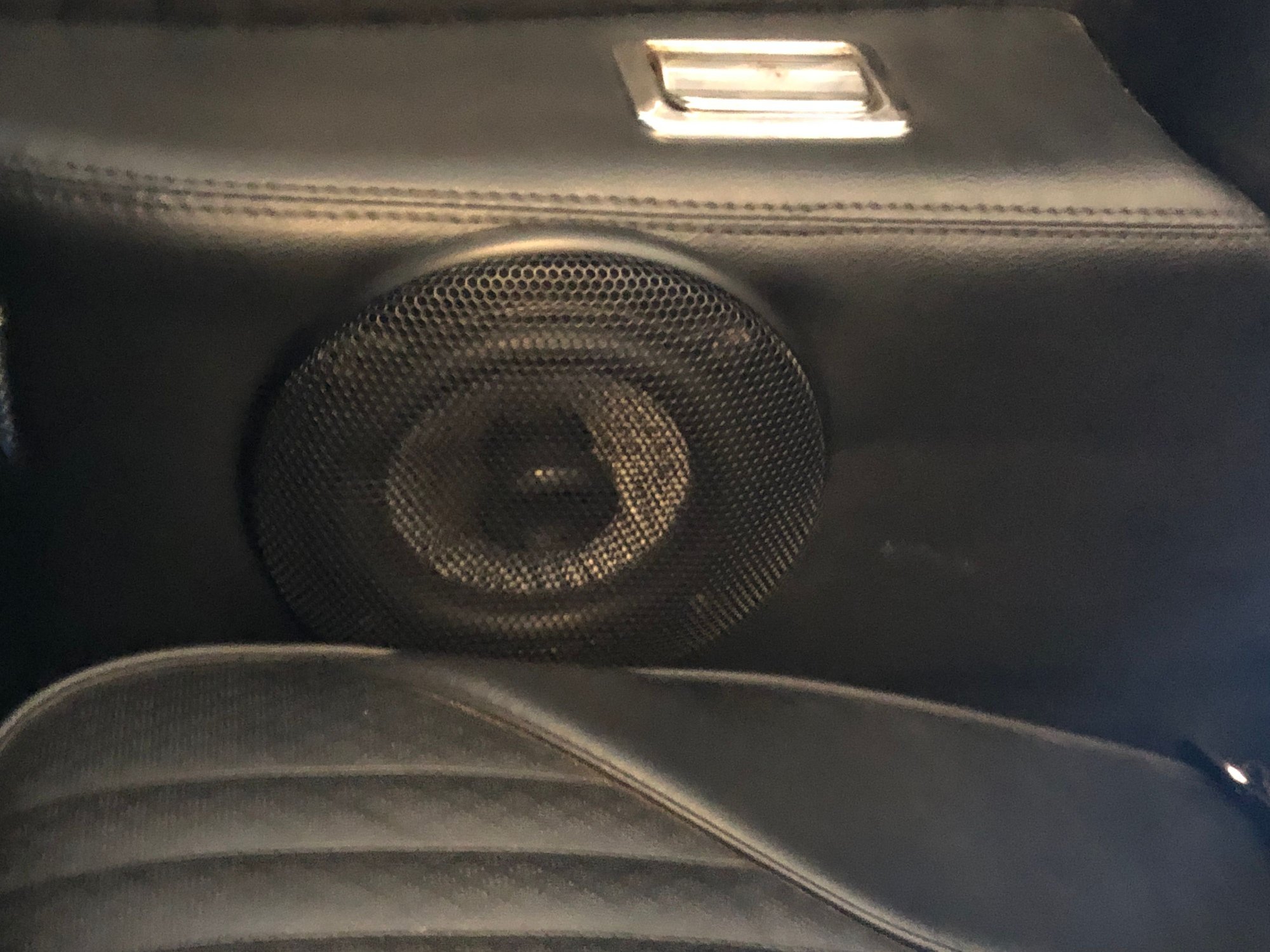

Did speakers in the rear armrests based on some of your experiences and advice. 5.5 inch Focal coaxial. Sounds great, it seems like you can’t really get decent sound without something in the back. I always hate to cut panels, but mine weren’t original anyway and you can get reproductions if you had to undo it.
