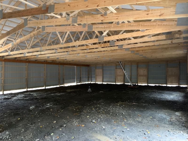

Looks like a good spot...
Pesky trees.
Ten millionteen tons of fill later...
Put sticks in holes.
Straighten them...
Nail on other sticks...
This 26,000 pound picker-upper will lift these trusses...
That looks a lot like a building.
Ahhhhh...
Drive in, unload trailer, drive straight out.
Place for the damned hosses.
Car Department.
Four stall doors and sliding aisle door.
Windows over workbench area.
His 'n' Hers Doors.
(Notice pile of red oak logs off to the left).
Ground's not done yet.
She gets two windows for an office.
Concrete will have to wait until Spring, I think, and I will assemble the interior, insulation, walls, etc. from there.
The building is 50'x72' total.
The good Lord willing and the creek don't rise, the plan is for four 12x12 box stalls, which I will build out with 2" thick red oak milled from the downed trees, with outside doors on one side, and a 9' aisle along the other side, then on the other side of the aisle, my wife's 14'x15' office (with two windows), which will include a "Mr. Ed door" to the adjacent 10'x10' Stall #5, next to a 13'x15' tack room, next to a 13'x15' storeroom, then past that, my 36'x50' garage, with 10'x50'x36" shelves along the inside wall, a workbench along the windows, and a lift midway between the doors.
I think it's turned out well so far, and I am extremely grateful to have been given the good fortune to have been able to get this far.

Yes, the building is complete without the concrete. It's inspected and usable, and the livestock areas will always have just compacted fill.
When they build the structure, they ring the bottom edge with a treated 2x6, which (ideally) serves as a form for the slab.
In my case, by the time the holes were bored and dug, then refilled, the crew had put the site off-level (or it was never level in the first place - there is some disagreement between the parties. My wife says the excavator showed her with his laser that it was perfectly level when he completed it). Regardless, when the structure was finished, the bottom sat a bit above the ground in most areas, and we are filling it to get the ground up to the building. In ideal terms, this is the best situation anyway, as the building will be drier if it's a bit high, and deciding how high is always something of a compromise. I've watched numerous commercial slab buildings go up over the years, and many seem to be filled to 2-3 feet above the surrounding ground level, so the 8" or so we need to go up isn't much, and it's mostly done by now anyway (I haven't got pictures of that yet).

When you pour your slab put down a minimum of one inch thick high density foam and tape the joints for a thermal break. Your floor will never sweat or be damp, it is well worth the extra expense in a colder climate.

With the new place and new animals and household projects, I don't have as much sitting-in-front-of-the-computer time.
Plus, I think having more space and being less hemmed in by people, noise, BS, etc. has made me a bit less mean (though my wife would never admit that), and given me a bit less drive to act like I know lots of stuff.
Or maybe I'm getting senile...
Yeah, I've been considering this. I've heard it both ways: Some say it'll help with moisture and coldness, others say it won't matter.
I'm also considering laying tubes for radiant heat, though I'm not planning any actual heater yet, and, since I wouldn't be heating it all the time, I'm not sure whether it's really worth the trouble, compared to just having a big gas or oil blower up on the ceiling.
The other concrete question I need to answer is whether it's better to reinforce with highway mat (steel mesh) or use the added plastic fiber (or both).
Originally Posted by Magna86
May I ask what you have in the building so far? And what the concrete will be? I'll be building something in the next year or so and trying to ballpark. It looks great both cars and horses should be quite happy!
The building itself was $61k: 50x72, 1' soffits, 6x50 overhang, glu-lam 6x6 posts, 2 9x9 overhead doors, 2 9x9 sliding doors, 4 4x7 dutch doors, 2 entry doors, 6 windows, doubled trusses (2' centers) over 16x50' with pull-down stairs for storage, metal roof, gutters, ridge and soffit vents, anti-condensation roof bubble-wrap insulation.
We locked in the price over a year ago, and steel has gone up since then, so you may not be able to find the same prices.
As for the concrete, I have no idea. I got a price on the concrete itself (2,400' of the 3,600' will be concrete) - 30 yards, 3,500psi, with plasticizer - about $4,500.
Since it's getting cold, and the fill isn't done yet (my guy has a day job, so works mostly weekends), I'm planning to pour in the Spring.

My concrete floors are rebar in 30" squares and wired where they cross, it is nothing that I specked out but is just how my cement contractor does it. When I did my own cement work I used wire mesh, I think the rebar is better. They use to add fiberglass to the concrete here as an option I don't know if it is still done or what is used now. I didn't like the fiberglass because the floors didn't seem to trowel out as smooth. I am not a concrete expert this only my personal opinion.
When I built my last house I put in floor heat in the garage its great when you are laying under a car or open and close the door its warm almost instantly. The down side is you need to turn the heat on the day before you plan to work out there.
A couple years ago I built a new shop at my retirement home in central Minnesota I put in a regular forced air furnace with AC. This is working out great especially when it is hot and humid in the summer, but we got a great deal on several of these units from a condo remodel project we worked on.

I use 1/2" rebar on 12" centers. I think the fiberglass needs to be burned off with a propane "weed burner". I have hanging furnaces in my garages at home and "up north". I'll install a window AC unit at home, high humidity in the garage sure reduces motivation in the summer.

They use microfiber now. The old fiber they used to use gave almost a hairy surface and was very difficult to finish. Mine with microfiber is like glass. The only down side is it's $10/cy but it's way cheaper than rebar or mesh. It's been three weeks and mine hasn't even cracked at the control joints
I had heard that about the fiber being hard to finish. Also that the surface was rough and uncomfortable to lie on.
I am glad to hear that the current stuff is different. This is definitely something that I am weighing as I decide what to do.
