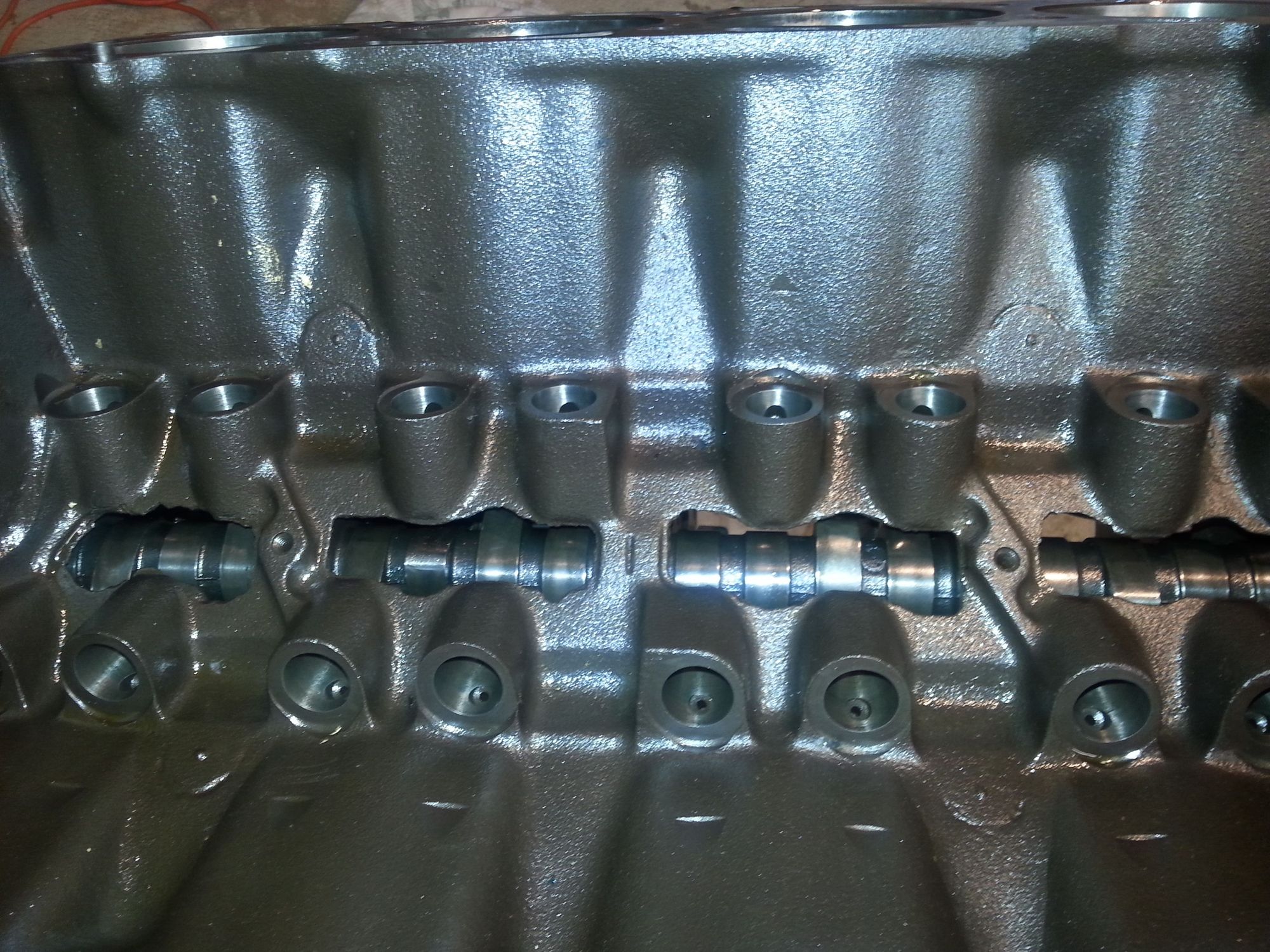

I can't find the two 1/4-20 bolts that secure this cam cover inside the lifter valley. They measure about .500" deep from the surface of the cover to the cam bearing below. How long of bolts should I buy? Should I put a thread locker on them and what's the recommended torque?

Stick something in the bold hole to measure the distance, then get the appropriate length bolts (or cut longer bolts to length).
I did this years ago when I attempted to install a Mondello valley tray. Then I found it would not fit under the Performer 350 intake (after Lynn had assured me on the phone that it would fit) so I don't have anything in the valley now.

I've probably got a couple of those small bolts on a core engine. I don't know where your located and if you want to put your project on hold for a few days. But if you want to go with factory bolts send me a PM or email. If you'd rather I can take some pictures but don't know how accurate my measurements would be on something that short. John

Don't you need to at least plug the two holes above the #2 and #4 cam bearings?
I'm not following. Is the concern that oil will lay on top of those bearings and get caked?

I don't know that's why I'm asking. Would oil come out from under the bearing and cause a decrease in oil pressure?

There is NO load on these bolts. Use whatever fits without bottoming out.
Your kinda overthinking this a bit. Use threaded rod and use nuts.

No.
