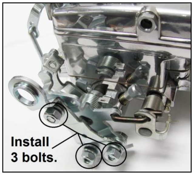

I just received my throttle bracket from Summit, Holley part #1952, and I am confused. Does the throttle cable attach to the big hole at the top of the bracket (that hole seems way too big) or does it attach to the smaller hole below the large hole? Anyone have a picture of the bracket installed?

Can they email you a picture or drawing? The website says its for the sniper EFI. Keep us posted.

from garys link above if you click on the tech resources tab there are instructions and a pic !!!
Thanks for all of the replies. I got the bracket today and installed it. Got a blister pack of plastic carburetor linkage bushings from O'Reilly's, had to shave down the width of the one that fit in the eyelet and put a bolt with a shoulder on it (not threaded all the way to the head) and a locknut. Then I found out the engine wouldn't idle down because the bracket hit a linkage rod on the side of the throttle body so I had to cut that third bolt hole off the bottom of the bracket. Now all I need is a spacer as the bracket hits the bottom of the air cleaner. WHEW! I took a photo with my phone and will post it when my secretary figures out how to get it on the forum.
